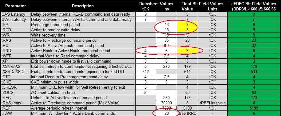

    Meanwhile I have more information on this topic. As I have not seen that MDLL clock is half the rate of PHY I used the wrong clock (333.33MHz instead of 666.66MHz).
    So some values are now fine. But still some values do not match. The picture below shows the values that lead to the register values used in the file "AM571x_ddr_config.gel".

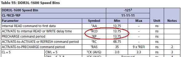

    But the values for "tRP", "tRCD", "tRRD" and "tFAW" do not match with the values from the "MT41K256M16HA-125" datasheet.
    As of my understanding the values should be:
    - tRP=13.75ns
    - tRCD=13.75ns
    - tRRD=4CK or 7.5ns
    - tFAW=40ns
    With those values from the datasheet the "Final bit field values" would match with the "JEDEC bit field values".

  • Why have you entered 13ns instead of 13.75ns for tRP and tRCD? As for tRRD, it should be "greater of 4CK or 7.5ns", in this case 7.5ns is greater than 4*1.5ns=6ns, so tRRD should be 7.5ns.
  • Biser,
    I have entered for example 13ns for tRP to get the register values used in the TI gel files and the board support packages for the AM571x IDK Evaluation board. For me this values are wrong. For tRP it should be 13.75ns.
    That is exactly my question. Why is TI using values that, in my opinion, do not match with the DDR3L datasheet.
    Patrick

    Looking at the above registers and the capability of AM571x, the DDR clock should be set to 666MHz. For the TI GEL file settings, the DDR speed grade selected is DDR3-1333 and the parameters are set for that speed grade since the DDR interface is only running at 666 MHz clock (DDR3-1333) even though the memory part is capable of running at a DDR clock of 800 MHz (DDR3-1600)
    Please verify if this resolves the discrepancy you noted.
    Regards, Siva

    But for the populated DDR3L SDRAM "MT41K256M16HA-125" those parameters should be set as follows (for DDR3 frequency of 666.66MHz):
    tRP=9
    tRCD=9
    tRRD=6
    Because minimal values from DDR3 SDRAM "MT41K256M16HA-125" (DDR3L-1600 Speed Bins) datasheet are:
    tRP=13.75ns
    tRCD=13.75ns
    tRRD=4CK or 7.5ns
    tFAW=40ns
    And this leads into a "EMIF_SDRAM_TIMING_1" register value of: 0xD3337834
    Patrick

    As I pointed out earlier, the speed bin table used is DDR3-1333 for deriving the timing values. Even though the part is capable of running at DDR3-1600, the memory parts per JEDEC are required to also run at the lower speed bins.
    Given this, the values to be used should be for DDR3-1333, tCK = 1.5ns
    tRP = 13.5ns (9 tCK)
    tRCD = 13.5ns (9tCK)
    tRRD = greater of 4 tCK or 6ns (4 tCK)
    The actual values programmed should -1 of the desired value - please see the TRM description in Table 15-146 which explains this requirement.
    Therefore, the values programmed should be:
    tRP = 8 tCK (9-1)
    tRCD = 8 tCK (9-1)
    tRRD = 3 tCK (3-1)
    which perfectly aligns with what you have noted above.
    Regards, Siva

    If those values are right, why do they not correspond to the values in the "JEDEC Bit Field Values" (given the populated DDR3 RAM with the used frequency)?
    Why are those values with a yellow background in the EMIF Tool (Warning)?
    Is this a EMIF Tool issue?
    Patrick
  • Patrick
    The speed bin table (referenced as in JEDEC spec) is referenced from the selection made in Step 1: Sytem Details tab, Detail #15. If you select DDR3-1333 and use the DDR memory timing information from the corresponding DDR3-1333 speed bin tables, there should not be any errors. Essentially, the user selection in Step1 - System Details and the user input values in Step 3- DDR timing should correspond to the same speed bin tables. If not, the tool will provide the warnings in case the min. timings are violated.
    If you still have questions, attach a spread sheet that matches your configuration and highlight the specific concerns you have
    Regards, Siva
