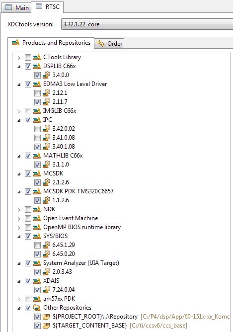

    Here is the list of packages we use:
  • Steve,
    Unfortunately, this is a fairly old software baseline and we are no longer support the MCSDK 2.x product so this will take us a while to setup at our end. Can you indicate if you are using the CSL from MCSDK for the UART and EDMA configuration or do you have your own driver code that implements the functionality.
