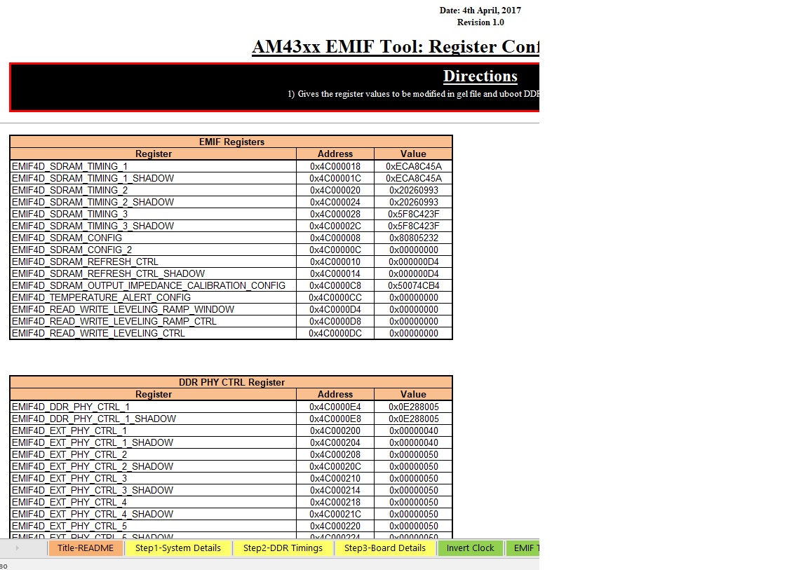

Hello. We use 16-bit lpddr2 module (IS43LD16640C-25) with am4372 processor.
To configure EMIF we use "AM43xx EMIF Tools".
Calculated register values was written into gel-function to init EMIF when connected to core in CCS.
But DDR2 not work properly. In "CCS: memory view" at 0x80000000 and 16 bit config i look random (RRRR) words and work (OK) words:
0x80000000: RRRR RRRR RRRR RRRR OK OK OK OK
0x80000010: RRRR RRRR RRRR RRRR OK OK OK OK
0x80000020: RRRR RRRR RRRR RRRR OK OK OK OK
0x80000040: RRRR RRRR RRRR RRRR OK OK OK OK
(OK) words write and read successfull, (RRRR) word read random values after refresh memory view window.
It's look as fail every four low address in eight. What configurable EMIF parameters may have this result?

    There are registers from Code Composer View Memory at 0x4c000000 after initialize RAM GEL function run:
    0x4C000000    EMIF_EMIF4D_MOD_ID_REV
    0x4C000000    50440500
    0x4C000004    EMIF_EMIF4D_STS
    0x4C000004    40000004

    0x4C000018    EMIF_EMIF4D_SDRAM_TIMING_1
    0x4C000018    00000000
    0x4C00001C    EMIF_EMIF4D_SDRAM_TIMING_1_SHADOW
    0x4C00001C    00000000
    0x4C000020    EMIF_EMIF4D_SDRAM_TIMING_2
    0x4C000020    20260993
    0x4C000024    EMIF_EMIF4D_SDRAM_TIMING_2_SHADOW
    0x4C000024    20260993

    P.S.:
    I modify standart script from TI : "\ti\ccsv8\ccs_base\emulation\boards\evmam437x\gel\AM437x_EMIFconfig_HWlvl.gel"
    In function AM43xx_LPDDR2_config() i place next code:
    hotmenu AM43xx_LPDDR2_config()
    	unsigned int i, read_reg;
        EMIF_PRCM_CLK_ENABLE();
    	GEL_TextOut("EMIF CLK enabled\n");
    	VTP_Enable();
    	GEL_TextOut("VTP controller enabled\n");
    	GEL_TextOut("Checking if DLL is ready...\n");
        WR_MEM_32(CM_DLL_CTRL, RD_MEM_32(CM_DLL_CTRL) & ~0x00000001 );
    	//wait for DLL ready
    	while((RD_MEM_32(CM_DLL_CTRL) & 0x4) == 0);
    	GEL_TextOut("DLL is ready\n");
        GEL_TextOut("Configuring DDR IOs and Control Module registers...\n");
        GEL_TextOut("Starting RILI5 LPDDR2 configuration\n");
    //THRESOLD BURST
        WR_MEM_32( 0x4C000120, 0x0);
    //EMIF REGISTERS
        WR_MEM_32( 0x4C000018, 0xECA8C45A);
        WR_MEM_32( 0x4C00001C, 0xECA8C45A);
        WR_MEM_32( 0x4C000020, 0x20260993);
        WR_MEM_32( 0x4C000024, 0x20260993);
        WR_MEM_32( 0x4C000028, 0x5F8C423F);
        WR_MEM_32( 0x4C00002C, 0x5F8C423F);
        WR_MEM_32( 0x4C000008, 0x80805232);
        WR_MEM_32( 0x4C00000C, 0x0);
        WR_MEM_32( 0x4C000010, 0x000000D4);
        WR_MEM_32( 0x4C000014, 0x000000D4);
        WR_MEM_32( 0x4C0000C8, 0x50074CB4);
        WR_MEM_32( 0x4C0000CC, 0x0);
        WR_MEM_32( 0x4C0000D4, 0x0);
        WR_MEM_32( 0x4C0000D8, 0x0);
        WR_MEM_32( 0x4C0000DC, 0x0);
    //DDR PHY CTRL REGISTER
        WR_MEM_32( 0x4C0000E4, 0x0E288005);
        WR_MEM_32( 0x4C0000E8, 0x0E288005);
        WR_MEM_32( 0x4C000200, 0x00000040);
        WR_MEM_32( 0x4C000204, 0x00000040);
        WR_MEM_32( 0x4C000208, 0x00000050);

  • Hi Sergey, in your GEL, you need to follow a little bit of the sequence of the original GEL for proper DDR initialization.  After write to all of the registers in the EMIF and PHY, you need to follow the sequence below to ensure the memory gets initialized properly and that you wait until the LPDDR2 has completed its initialization:
    //finished with EMIF config
    //set init bit back to enable
    WR_MEM_32(EMIF_SDRAM_REF_CTRL,0x3000);
    //this write initiates and EMIF initialization and also latches values to PHY
    WR_MEM_32(EMIF_SDRAM_CONFIG,LPDDR2_SDRAM_CONFIG);
    WR_MEM_32(EMIF_SDRAM_REF_CTRL,LPDDR2_REF_CTRL);
    WR_MEM_32(EMIF_SDRAM_REF_CTRL_SHDW,LPDDR2_REF_CTRL);
    GEL_TextOut("\n\nEMIF configuration is complete\n",,,,,i);
    //at this point, we can check the MR0 register of the LPDDR2 memory to ensure auto-initialization in memory is complete
    //when complete, DAI should be 0x0, RZQI should be 0x3
    //check memory datasheet for definition of these bits
    GEL_TextOut("Waiting for LPDDR2 autoinitialization to be ready...\n");
    GEL_TextOut("\n");
    WR_MEM_32(EMIF_LPDDR2_MODE_REG_CFG,0x00000000);
    while((RD_MEM_32(EMIF_LPDDR2_MODE_REG_DATA) & 0xFF) != 0x18);
    GEL_TextOut("LPDDR2 autoinitialization complete!\n");
    Then you can write the LPDDR2 mode registers to complete the init.
    Also, did you perform any bit swapping when laying out the board traces?
    James
  • Thank you James.
    1. I check connection to LPDDR2 - there are no swapping in data lines on board traces.
    2. I see this code in original gel file.
    Now I add this code to my sequence before write mode registers. Script print "LPDDR2 autoinitialization complete!\" in console.
    But no visible changes in memory view window.
    When I add this, I use my values for LPDDR2_SDRAM_CONFIG = 0x80805232, LPDDR2_REF_CTRL = 0x0000081A.
    I try to read LDPPR MODE REGISTER at 0x5 - manufactured ID - it is 0x1B, what correspond to datasheet.
    I remind you:
    - First four words in memory view at address 0x80000000 read 0x6CFE, 0xFFA1, 0XFFE6, 0X4CFC. Next read values after refresh 0x6CFF, 0xFFA1, 0xFFE6, 0x4EFC. And next read values in values changes some bits.
    - If I write throught Code Composer Memory View values 0xFFFF, 0xFFFF, 0xFFFF, 0xFFFF, then next read values 0x7FFF, 0xFFFF, 0xFFFF, 0x7FFF. after refresh sometimes first values have 0xFFFF, sometimes 0x7FFF. next 3 values no changes.
    Words at address 0x80000008 - 0x8000000F read and write successful.
    And next address situation repeated. Four words read random values, four words read and write successful, four words read random....
  • With that new information, it looks like a timing issue.  Furthermore, if i look back at the register dump you provided, it looks like one of your timing register did not get written properly
    0x4C000010    EMIF_EMIF4D_SDRAM_REFRESH_CTRL
    0x4C000010    000000D4
    0x4C000014    EMIF_EMIF4D_SDRAM_REFRESH_CTRL_SHADOW
    0x4C000014    000000D4
    0x4C000018    00000000
    Also, the refresh control register doesn't look correct based on the speed you should be running the DDR (266MHz)
    I used the datasheet of the memory vendor you provided, and filled out the EMIF tool spreadsheet.  There are several discrepancies which i found.  Try using the results that i got in the attached spreadsheet, and once you have plugged those into the GEL, ensure a data dump of the registers reflects those values.
    If you have questions on the spreadsheet results, let me know.
    James
    e2epost_SPRAC70_AM437x_EMIF_Configuration_Tool_V20.xlsx
  • Thank you very much James!!!!
    Your remark about zero value of EMIF_EMIF4D_SDRAM_TIMING_1 is a key to resolve my problem.
    It's amazing, but GEL-script write to EMIF_EMIF4D_SDRAM_TIMING_1 ignored by CCS or hardware and EMIF_EMIF4D_SDRAM_TIMING_1 hold zero values.
    I add next instruction at the end of Initialize script and Code Composer write register successful.
        WR_MEM_32( 0x4C000018, 0xEA86B491);
        WR_MEM_32( 0x4C00001C, 0xEA86B491);
    After that my LPDDR2 work successful. I try to test RAM later, but this problem resolved.
    Thank you.
    P.S. If you have idea about strange CodeComposer logic or script sequence error please let me know.
