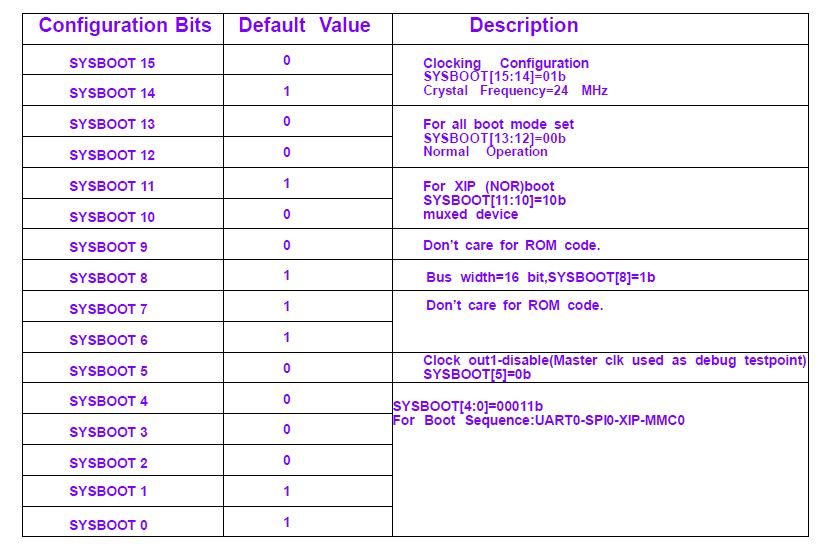

Dear Sir/Madam,
In my current design, I'm using AM3354BZCZD80 in XIP mux2 boot mode. The boot mode set is SYSBOOT[4;0]=00011. Boot Sequence: UART0-SPI0-XIP-MMC0. I'm able to flash the files to FLASH through UART0 boot and if I enter the "RESET" command from there (now the system is booted on UART0 boot mode) it will reset the board and start booting from the flash. But if I powered off and on the board, it is not booting from flash at all. the board is printing "CCCCC" on the console port. Attaching the schematic portion of the same.
DDR3 is the main memory interface.
Can someone please help me to rectify the issue?
