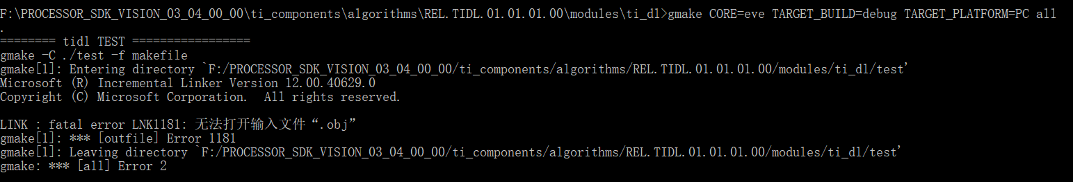

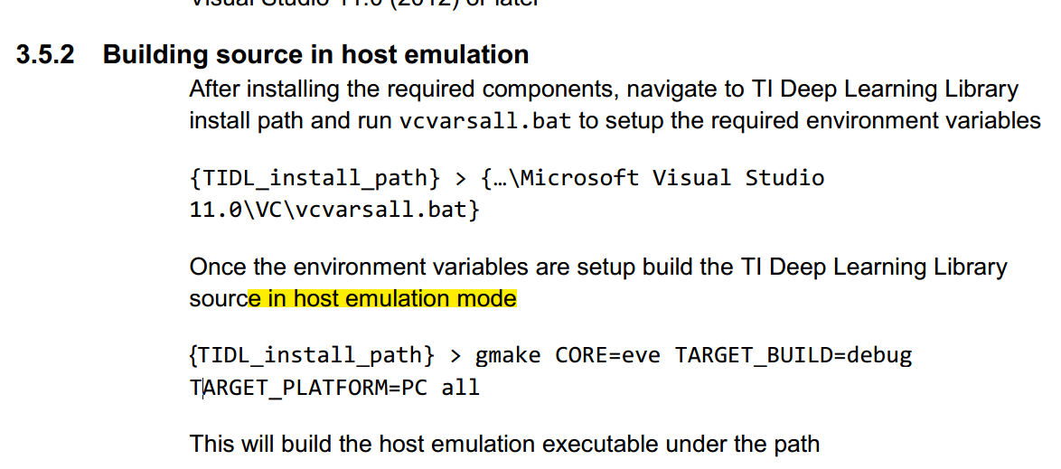

              In the paper called deep learning user guide , I could not bringup the host emulation mode ,the ref information and the error as following:
The command is so simple, however it did not work. Could you please help me figure out how to set it ?
BR
    You need source code release of TIDL to build in host emulation mode.
    Do you have access to it?
    Praveen
  • No,I did not have that code. However I really saw the makefile. There is the ./src directory in the make process. Could you please kind enough to offer me the code? I want to research that and do some important examples to show the capability of tda2x processer. If it can do well (especially DL related algorithm) and develop easily , there will be more cooperation.
    Source code will be shared only through CDDS. Please contact you local TI FAE to get access to CDDS account and source code release.
    Praveen
  • Any other method? The communication process of the FAE in China is too Inefficient. Let me offer you the order of your company's TDA2x EVM, is it OK ?
  • No, I cannot help here further. Please contact your local TI representative only, that is the only way many customer got the source code.
    Praveen
  • In fact, the representative delayed me so long. I could not get the feedback from him/her. How can I get forward to my work? Could I talk the manager with yours or the departmant manager?
  • Hi ,
    The TIDL Host emulation is NOT needed for running a CNN network on TI device (It is only needed for de-bugging purpose). The binary release available in VSDK package could run CNN inference in TI devices, use this binary release for your network deployment.
    Kumar.D
