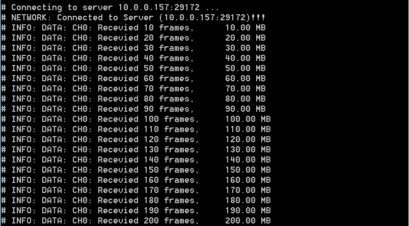

    And the associated console output from the network tool:
    Richard

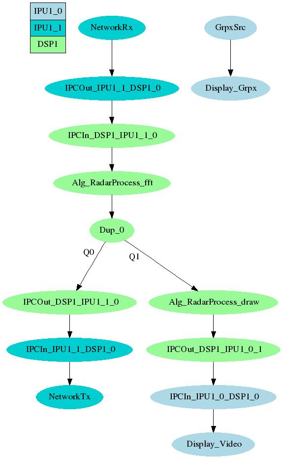

  • Hi Richard,
    If you notice the usecase the output in RGB565 would be visible on the DSS output. The output of the network is the FFT magnitude values not converted to a displayable format. If you happen to have MATLAB and you can use this to see the bin file plotted as a 3 D plot of magnitude versus range versus doppler.
    Can you try hooking up HDMI TV perhaps to the HDMI connector on the EVM to see the data live?

  • Hi Piyali,
    I hooked up an HDMI monitor and was able to see the heat map displayed.
    I will try to have the bin file plotted in MATLAB.
