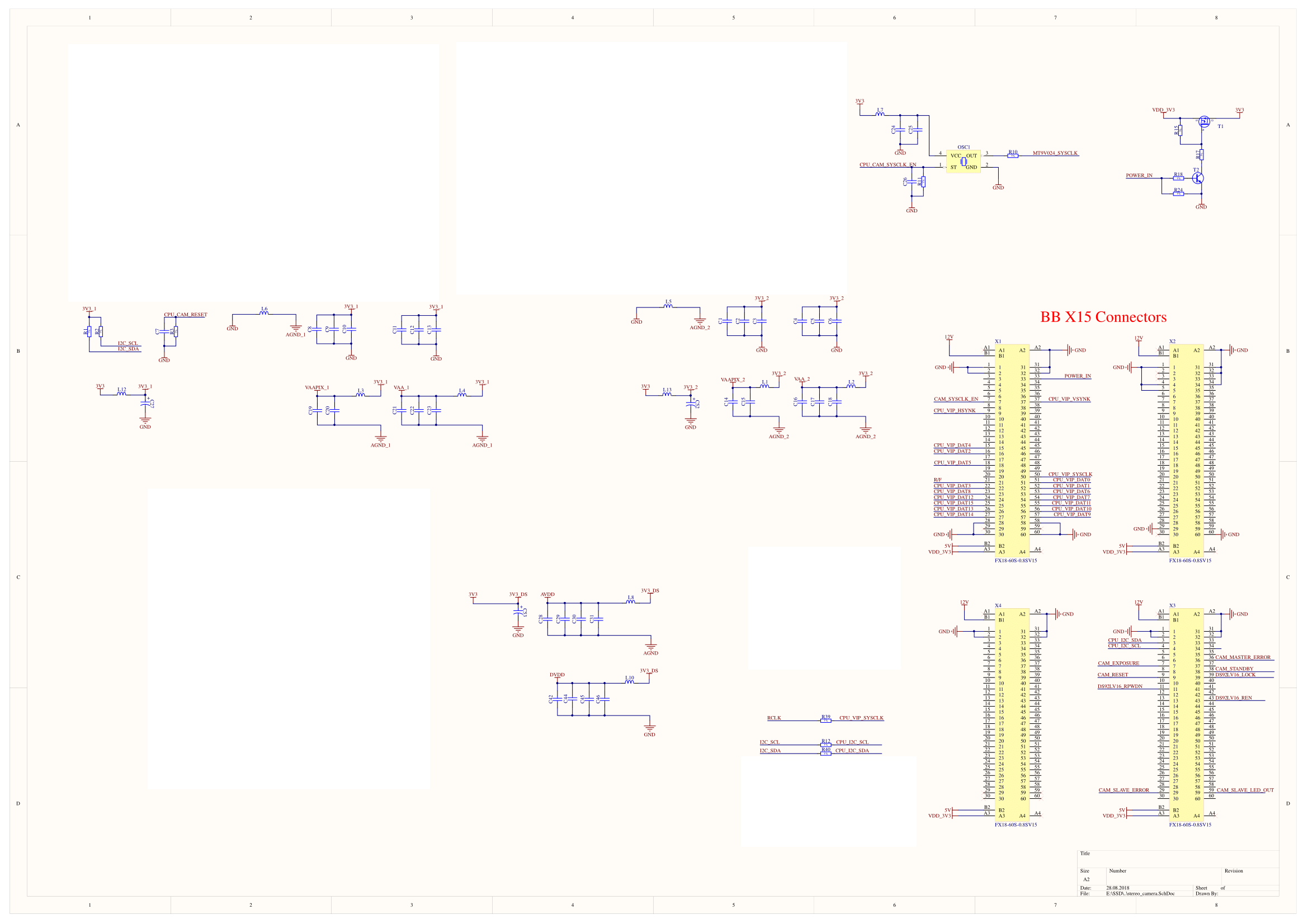

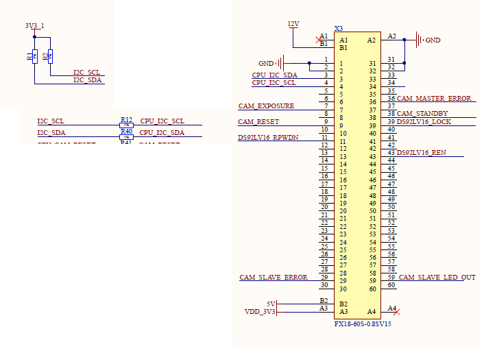

Hello TI,
I would like to enable i2c5 in my AM57x based ARM board and getting timeout error while accessing the i2c5 bus. And I am using the very latest TI SDK and same issue.
I posted the below forum to make sure the HW connections, as per Biser, it looks good.
We have to solve this issue very quickly as we are going to manufacture PCB for this design, so we have to close this issue asap.
Can you please help us on this ?
Here is my pinmux settings for i2c5 bus (i2cdetect -y -r 4)
When I do "i2cdetect -y -r 4", and getting below errors in linux console.
Can you please check if need any change in SW ?
[ 0.563976] omap_i2c 4807c000.i2c: could not find pctldev for node /ocp/l4@4a000000/scm@2000/pinmux@1400/i2c5_pins_default, deferring probe
[ 109.620862] omap_i2c 4807c000.i2c: timeout waiting for bus ready
[ 110.640847] omap_i2c 4807c000.i2c: timeout waiting for bus ready
[ 111.660858] omap_i2c 4807c000.i2c: timeout waiting for bus ready
[ 112.680841] omap_i2c 4807c000.i2c: timeout waiting for bus ready
&i2c5 {
status = "okay";
pinctrl-names = "default";
pinctrl-0 = <&i2c5_pins_default>;
clock-frequency = <100000>;//100KHz
i2c5_pins_default: i2c5_pins_default {
pinctrl-single,pins = <
DRA7XX_CORE_IOPAD(0x36B4, (PIN_INPUT_PULLUP | PIN_INPUT_SLEW | MUX_MODE10))// mcasp1_axr0.i2c5_sda
DRA7XX_CORE_IOPAD(0x36B8, (PIN_INPUT_PULLUP | PIN_INPUT_SLEW | MUX_MODE10))// mcasp1_axr1.i2c5_scl
I am using the below I2C5 on Beagbleboneblack x15 board (AM57x)
Can you please check that whether I have configured the pinmux properly for this i2c5 pins.

    Titus Stalin said:
    I have got 0.8V on both pins, what could be the problem here ?
    Pins G12 and F12 correspond to voltage domain vddshv3.  Please measure the voltage observed on vddshv3 on your board.  Based on your pullups, this should be 3.3V.
    Titus Stalin said:
    R1 & R2 are 4.7K resistors and R12 & R40 are 30Ohm resistors.
    Looking at R1 and R2, can you confirm that the voltage rail to which they're being pulled is 3.3V?  In other words, are you seeing 3.3V on one side of the resistor and 0.8V on the other side?  (I want to to make sure that supply rail isn't sitting at 0.8V for some reason, in which case it would make sense why the I2C is only pulled up to 0.8V.)
    Similarly, can you look carefully at R12 and R40 to determine the direction of the voltage drop?  Alternatively, if you remove R12 and R40, do you see the I2C5 pin rise to 3.3V (i.e. due to internal pullup)?  In that scenario you would need to determine why you have 0.8V at the board level.
  • Thanks Brad for your pointers.
    Yes, I am not able to see the 3V3 in pull up resistors & other 3V3 test points, we are debugging the board, will get back if need any further help.
    Thanks again Brad.

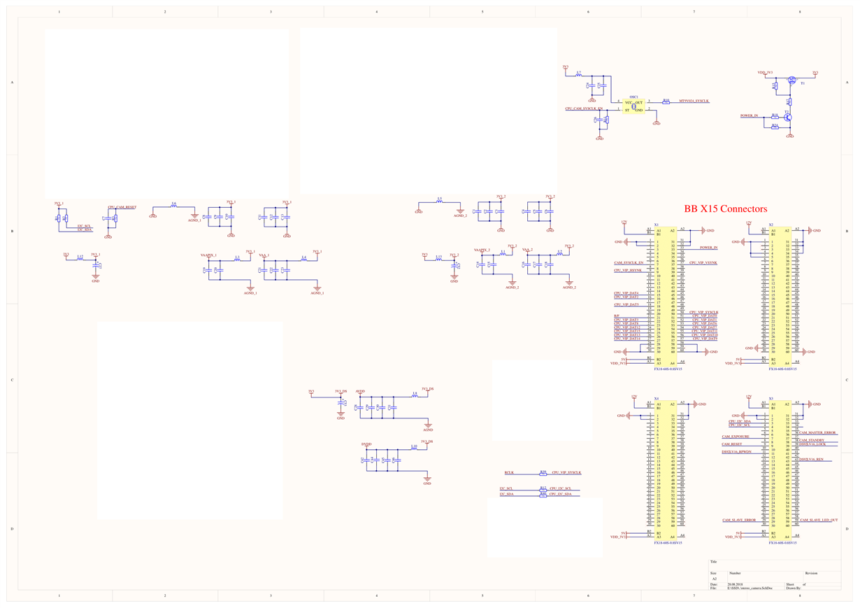

  • Hi Brad,
    Thanks for your support so far.
    Started to debug the HW board and found the following observations on board.
    I have attached the schematics except the I2C slave device which design is propitiatory, I can send to you complete schematics via private chat.
    Checked the continuity between C53 (+ve) and board 3.3V pin connector (X1.A3), no continuity found.... its not expected, isn't it ?
    And also checked the voltage across, C27, C52, C44, C46, C29, and L12 to GND, & L13 to GND, mesaured voltage just 0.368V on all combinations.
    Any PCB design issue ?
    Unfortunately we designed only one board for now, unable to do the same with other boards.
    I can see the connectivity C52 & C27 via L12 & L13, so can we connect and put one wire externally from board 3.3V connector(X1.A3) to C57(+ve), this way board get powered up through 3.3V right ? can you please confirm ?
    We need to start new PCB and HW design  based on the current issue, so we completely blocked and not sure how to proceed further.
    Thanks for your help.

  • Hi Paul,
    Thanks for your response.
    I have attached the schematics and my i2c slave devices are cameras, so your suspect is correct on power requirement.
    We enable the power to the PCB via GPIO (POWER_IN), and getting 1V when I write HIGH.
    I am using 12V, 1.5A power source to beaglebone X15 board.
    Can you please let me know what could be the problem.
    Enable/Disable pull up in POWER_IN using GPIO5_12 POWER_IN T1.S T1.D T1.G T1.D + R17 removed
    Enable 0.984V 3V3 0.461V 0.320V 1.035
    Disable 0V 3V3 0.36V 3V3                           0.36V
    T1.S, .D, .G -> Source, Drain, Gate of T1 transistor
