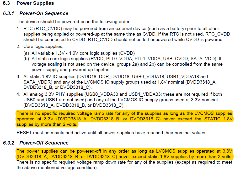

    Are you following the Power On sequence described i the datasheet section 6.3.1 Power-On Sequence?
    There is no specific required voltage ramp rate for any of the supplies as long as the LVCMOS supplies operated at 3.3V (DVDD3318_A, DVDD3318_B, or DVDD3318_C) never exceed the STATIC 1.8V supplies by more than 2 volts.
    I see you use 1.8V to enable 3.3V, so the 3.3V should never be more than 1.5V apart from the 1.8V rail (3.3V - 1.8V = 1.5V). Have you verified this?
    It follows the sequence written in the data sheet.
    Please tell me about this part in detail.
    Should we send the waveform of the power supply part?
    I was referring to this statement in the datasheet.
