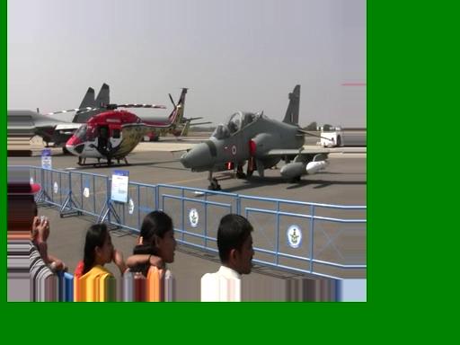

  • Hi Margarita,
    Thank you, your example helped a lot - but I am now getting odd results on playback. When I run playbin, the video plays with the proper framerate and colors, but the edges of the frames are green and the left and bottom areas of the frames are clamped to the pixel value at the corresponding left and bottom regions of the good looking part of the frame. It is difficult to describe so I have included an image of the problem below:
    I believe this has to do with print statements I am seeing from GStreamer indicating that it is cropping the frames:
    0:00:12.396840784   957 0xb5d316c0 INFO                  ducati gstducatividdec.c:692:codec_process:<decoder> active frame region 32, 24, 384, 312, crop 352x288
    0:00:12.653791490   957 0xb5d316c0 INFO                  ducati gstducatividdec.c:692:codec_process:<decoder> active frame region 32, 24, 384, 312, crop 352x288
    0:00:12.657835871   957 0xb5d316c0 INFO                  ducati gstducatividdec.c:692:codec_process:<decoder> active frame region 32, 24, 384, 312, crop 352x288
    0:00:12.663093583   957 0xb5d316c0 INFO                  ducati gstducatividdec.c:692:codec_process:<decoder> active frame region 32, 24, 384, 312, crop 352x288
    I am using the following commands.
    Encode:
    gst-launch-1.0 filesrc location=/home/root/am5728-gst-tests/video-samples/airshow_p352x288.yuv ! videoparse width=352 height=288 format=nv12 ! vpe ! ducatih264enc ! h264parse ! queue ! filesink location=/home/root/test.h264 sync=false
    Decode:
    GST_DEBUG=4 gst-launch-1.0 playbin uri=file:///home/root/test.h264 fbdevsink device=/dev/fb1
     sync=false
    How can I disable cropping and get the appropriate frame size from the test video? Thanks.
    Please try this:
    /etc/init.d/weston stop
    or
    /etc/init.d/weston start
    gst-launch-1.0 playbin uri=file:///home/root/test.h264 video-sink=waylandsink
    BR
    Margarita
    I have tried on my side, I do not see the green lines.
    Here are the pipelines that I have tested:
    gst-launch-1.0 filesrc location=test1.h264 ! queue ! h264parse ! 'video/x-h264' ! ducatih264decvpe ! 'video/x-raw,format=(string)NV12,width=352,height=288' ! kmssink
    gst-launch-1.0 filesrc location=test1.h264 ! queue ! h264parse ! 'video/x-h264' ! ducatih264decvpe ! 'video/x-raw,format=(string)NV12,width=1280,height=720' ! kmssink
    BR
    Margarita
  • It turns out that GStreamer version 1.6.3 has the green lines bug and the newer gstreamer versions ( 1.12 ) seem to work fine.
    Thanks for the help on this.
    Phil
