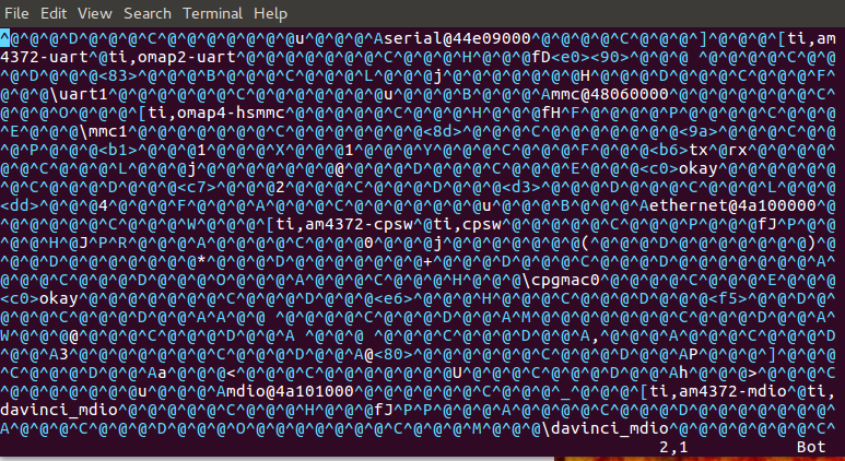

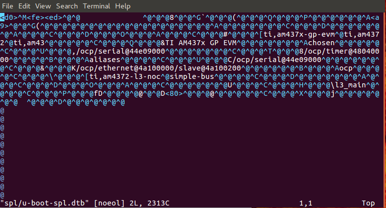

  • The MLO will use the dtb to determine the MMC pinmux configuration. Could you please provide the dts and <u-boot>/spl/u-boot.cfg files you're using? It may be necessary to have a dts primarily for the MLO that only defines the MMC1 (eMMC) configuration and one for u-boot that defines both MMC0 (SD) and MMC1.
    Also - Open file spl/u-boot-spl.dtb and check the mmc instance address (it should be mmc@481D8000)
  • I can only assume the dtb file your are reffering to is the compiled dts file am437x-sk-evm.dts which the full u-boot environment uses after interrogating the EEPROM, but it isn't clear to me which file MLO is using as a dtb. I've attached /spl/u-boot.cfg and that file respectivelty:

    . (I had to add '.txt' to the file names to allow uploading).
    I can't open spl/u-boot-spl.dtb for inspection since it's a binary file. I have already confirmed that the am437x-sk-evm.dtb is pointing to the correct hardware address for mmc1 control.
  • spl/u-boot-spl.dtb is the dtb the MLO uses. This u-boot-spl.dtb is generated based on the dts set by define CONFIG_DEFAULT_DEVICE_TREE (see spl/u-boot.cfg) In your u-boot.cfg file, CONFIG_DEFAULT_DEVICE_TREE is set to "am437x-gp-evm". So you'll need to make mmc changes in this dts file.
    BTW - you should still be available to open the binary file in "vi" and search for "mmc".
  • Here's what I get when I use 'vi' to view the binary, with and without the '-b' tag the output is the same. Some ASCII characters are present but adding the mmc2 definition to am437x-gp-evm.dts (using code that worked to add the eMMC in am437x-sk-evm.dts) didn't put any entries for mmc@481d8000. It's hard to tell because there are a lot of parts defined in the default dtb that aren't visible in ASCII in the file so it could be there or it may not.
    When I perform the build the files 'am437x-gp-evm.dtb' and 'u-boot-spl.dtb' both have new timestamps so I know they're getting rebuilt but it doesn't look like '<u-boot>/arch/arm/dts/am437x-gp-evm.dtb' is getting into the '<u-boot>/spl/u-boot-spl.dtb'. I tried adding the second mmc interface to 'am437x-gp-evm.dts' early on precisely because I saw it was the default used by u-boot but it didn't fix the problem. That was a step I took prior to making this thread. I just added the definition of the eMMC interface into the file now but I am unable to test it out on the hardware until tomorrow. However I did generate a copy of u-boot-spl.dtb with the original gp-evm dts and one with my modifications to compare if the interface definition caused any changes and there are only 5 bytes that are different between the 2 version so I don't think that solves the problem.
  • The DTS file am437x-gp-evm.dtb is parsed by SPL, however the Makefile in <u-boot>/dts removes all nodes that don't include the u-boot,dm-spl property. You can either change mmc1 to mmc2 in file <u-boot>/arch/arm/dts/am437x-gp-evm-u-boot.dtsi or add a new entry for mmc2.
