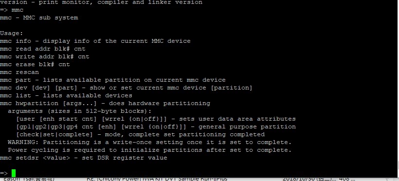

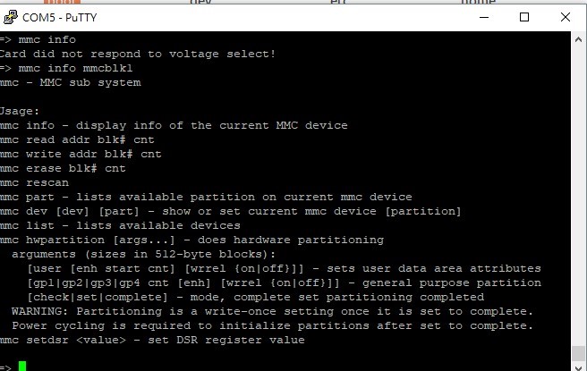

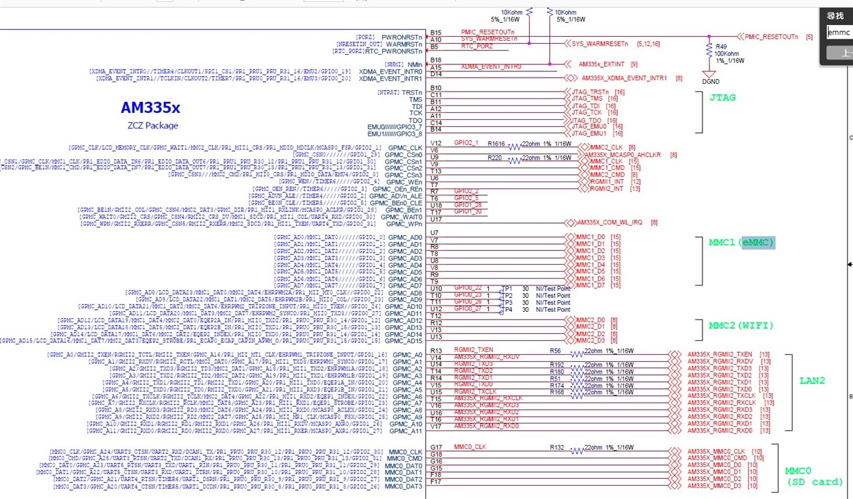

    Thank you for confirming this. Can you tell me more about the hardware and what you've done to validate that it is functioning correctly?
    Have you tried any eMMC commands in U-Boot to see if it functions properly there?

    Would you description detail or explanation the about  "more about the hardware and what you've done to validate that it is
    functioning correctly? " mean?
    Do you want me to provide an HW schematic to " Part for EMMC"?
    BR
    Egbert Liu

    Can you please stop U-Boot at a prompt to stop Autoboot and use the "mmc" commands to see what the board is listing?
    Please provide the output of the "mmc info" command from U-Boot, for example.
    You can use the environment to switch MMC devices, no reason to change the header files.
  • Hi RonB,
    pleaase refer below information for mmc command

  • Egbert,
    Could you actually run a few of the commands like "mmc part" and "mmc info" and "mmc list", and provide the output of them? Thank you.
  • Hi Rob,
    I follow your rule to screenshot  MMC info picture :
    but I current status emmc boot on cannot find kernel space, I don`t know why?
    I urgently need to know the location of the relevant files in the CODE, for example: u-boot/include/configs / am335x_evm.h
    This problem has deviated from the direction and has been tested and verify many steps, but it is still unable to find the key points of the problem. Can you tell me directly the question?
    Thank you
    BR
    Egbert Liu
  • Egbert,
    The output of "mmc part" and "mmc list" would still be very useful. Can you please provide these?
    It appears that U-Boot cannot find your eMMC device. You said you are using the pre-built files with a custom board. This will only work if the boards are identical for these interfaces. Is that true?
    More than likely you need to change U-Boot to account for the differences between your board and the SK. For example, do you have the eMMC hooked up to the same MMC port as the SK? If not, this will need to be changed.
    The changes you might need to make will be dependent on this information and will help me guide you in possible changes needed.
