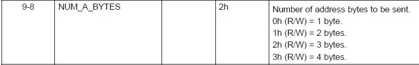

Reading the AM437x ARM Cortext -A9 Processors Technical Reference Manual: Page 3693
  • In order to be able to utilize 4 byte address mode, you must change the QSPI_SETUP_REG_0 field NUM_A_BYTES bits 9-8.
    • You must change this default value 0x20203 to 0x20303.

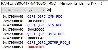

Following this information, upon the start of my program (This could be considered in main), I do all the initialization. The highlighted line is where I change the register value.
Before my register call:
/* Init SPI driver */
SPI_init();
/* Default SPI configuration parameters */
SPI_Params_init(&spiParams);
if(m_flashHandle == 0)
   /* Open QSPI driver */
   m_flashHandle = SF25FL_open(((QSPI_INSTANCE - 1)+(QSPI_OFFSET)), &spiParams);
   /* Get Hardware attributes */
   m_spiHandle = m_flashHandle->spiHandle;
   m_rxLines = QSPI_RX_LINES_QUAD;
   SPI_control(m_spiHandle, SPI_V1_CMD_SETRXLINES, (void *)&m_rxLines);
   m_hwAttrs = (QSPI_HwAttrs *) m_spiHandle->hwAttrs;
   /* Print flash Id */
   FlashPrintId(m_flashHandle);
if(QSPI_RX_LINES_QUAD == m_hwAttrs->rxLines)
   S25FLFlash_QuadModeEnable(m_flashHandle);
QSPI_REG(QSPI_REG_0) = FOUR_BYTE_ENABLE;

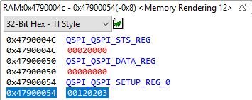

After my Register change call:
This is showing that on the Sitara board, 4 byte addressing mode is now enabled.

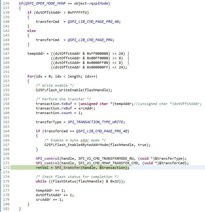

From here I enter into SF25FL_bufferWrite() in S25FL.c:

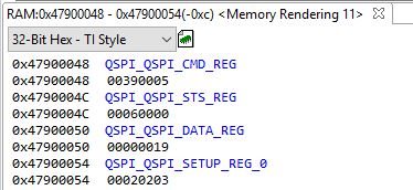

up until this point the register still reads the required: 00020303
Once I step past this instruction, the register changes too:
This change in the register changed the value to a write command sending only 3 address bytes.
The problem with this is that this part of code is a loop, and so for all of the loop is sending three address bytes.
Any insight on how to get 4 byte address mode working with MMAP mode would be greatly appreciated.
