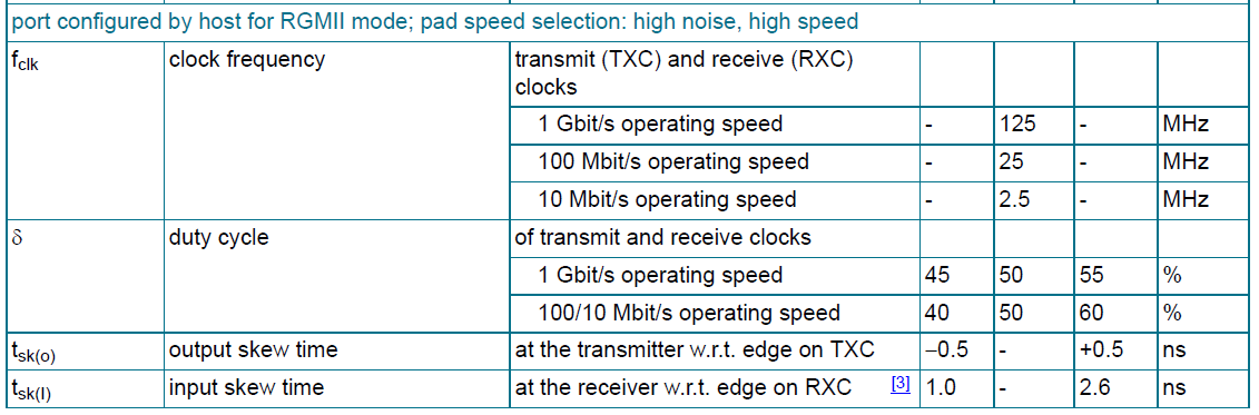

    Yes. I am operating TDA in gigabit mode. I found delay requirement from ENET port switch datasheet as  "RGMII requires and external delay of between 1.5 ns and 2 ns on TXC and RXC" and configured delay for TXC ad RXC as in attachment delay_config.txt.
    Other config for RGMII mode found in switch datasheet is in the image below.
    Attached Full GMAC register dump in GMAC_registers.dat (with internal delay disable).

  • Tejeswini,
    Can't figure out anything from delay_config.txt. Which part of "if" loop is getting executed?
    Have you configured any delays in Switch? If not, enable delays in TDA using earlier shared function.
    Please dump register data uisng registers window in CCS so it would have registers addresses with value. Right click and export there.
    I can't figure out anything from what you have shared.
  • Hi Prasad,
    If condition for adding delay is being executed. And, i am not sure if the switch is configured for the delay. I will update when i have an answer for that. Please find the attached registers dump in txt format. GOOD TX frames are actually incremented in STAT register.
    Tejeswini

    Trying to summarize the issue and current status:
    1) Noticed GOOD_TX_FRAMES increments on sending frames but no frames received on Wireshark.
        GOOD_RX_FRAMES increments (on trying to ping). But no response seen on PC.
    2) Attached is the NDK configuration.
    3) GMACSW config added as below:
    pGMACSWConfig->cptsCfg.enableCPTSEvents = 1;
    pGMACSWConfig->cptsCfg.cptsInputFrequency = 266000000;
    pGMACSWConfig->macInitCfg[i].macConnectionType = MAC_CONNECTION_TYPE_RGMII_FORCE_1000_FULL;
    pGMACSWConfig->macInitCfg[i].mdioModeFlags = MDIO_MODEFLG_NOPHY;
    And, attached GMACSW registers (reg_dump). (Expected TXC and RXC at 125 MHz)
    4) Pin Muxing for RGMII as below:
    WR_MEM_32(0x4A003650, 0x00010000);
    WR_MEM_32(0x4A003654, 0x00010000);
    WR_MEM_32(0x4A003658, 0x00010000);
    WR_MEM_32(0x4A00365C, 0x00010000);
    WR_MEM_32(0x4A003660, 0x00010000);
    WR_MEM_32(0x4A003664, 0x00010000);
    WR_MEM_32(0x4A003668, 0x00050000);
    WR_MEM_32(0x4A00366C, 0x00050000);
    WR_MEM_32(0x4A003670, 0x00050000);
    WR_MEM_32(0x4A003674, 0x00050000);
    WR_MEM_32(0x4A003678, 0x00050000);
    WR_MEM_32(0x4A00367C, 0x00050000);
    5) Dumped switch registers while trying to ping TDA. Registers show
    number of frames transmitted to the respective port since power-on or reset : Incrementing
    Number of MAC-level correct frames received on the respective port since power-on or reset : Zero
    Number of frames dropped for various reasons since the power-on reset : Zero
    6) Disabled delay on TDA using below code (reason, delay is added on Switch side):
    regValue = CTRL_MODULE_CTRL_CORE_SMA_SW_1;
    /* Disable half cycle delay for RGMII0 */
    regValue |= (0x1 << 25U);
    /* Disable half cycle delay for RGMII1 */
    regValue |= (0x1 << 26U);
    CTRL_MODULE_CTRL_CORE_SMA_SW_1 = regValue;
    Thanks.
    Tejeswini
