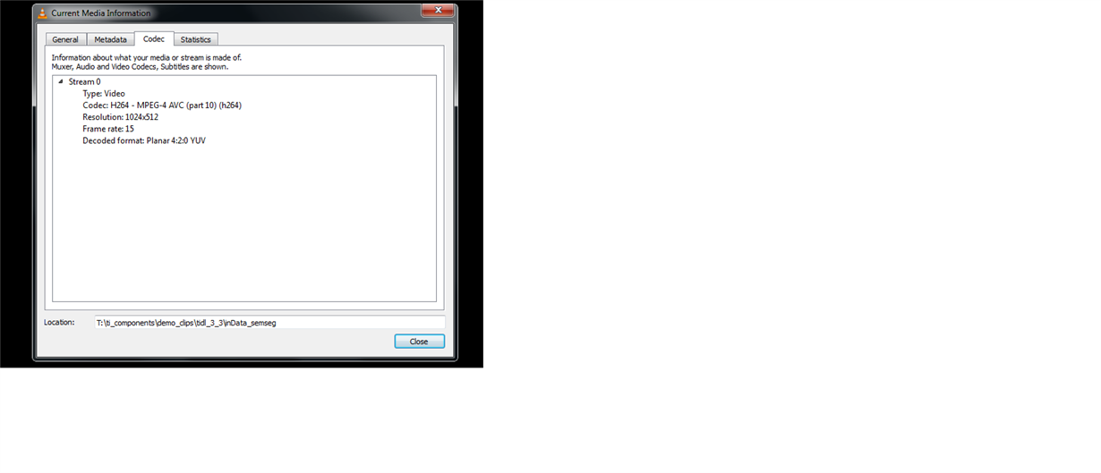

    What size of video do I prepare for "TIDL Semseg Usecase input data file (inData_semSeg)"?
  • Hi Eric,
    Ensure input video width & height should be 1024x512 as in UC, it is defined as
    #define SEMSEG_INPUT_WIDTH          (1024)
    #define SEMSEG_INPUT_HEIGHT         (512)
    PSB for details of the test video We used for testing
