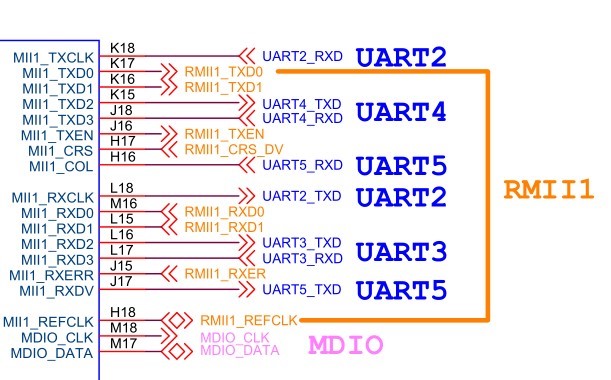

I met one software issue with a RMII design on customers' board. Please help to check as below.
Hardware platform:
Customers’ product board with RMII design.
we have designed an board based AM3357,  according to ICEV2.
the difference between our board and ICEV2 is that we have three ethernet port: 2 for PRU-ICSS and 1 for CPSW. there is no pin reuse in our board.
the PHY in our board is
Software environment:
in Uboot and Linux environment, RMII is set by device tree, the port can work, we can ping it success. so there is no hardware problem in our board.

firstly, we modified the am335x_icev2_pinmux_data.c. the new CPSW discription is shown as
#if defined(BUILDCFG_MOD_CPSW)
static pinmuxPerCfg_t gCpsw0PinCfg[] =
/* MDIO -> mdio_clk -> M18 */
PIN_MDIO_CLK, 0, \
PIN_MODE(0) | \
((PIN_PULL_TYPE_SEL) & (~PIN_PULL_UD_EN & ~PIN_RX_ACTIVE)) \
/* MDIO -> mdio_data -> M17 */
PIN_MDIO_DATA, 0, \
PIN_MODE(0) | \
((PIN_PULL_TYPE_SEL | PIN_RX_ACTIVE) & (~PIN_PULL_UD_EN)) \
/* RMII1 -> rmii1_crs_dv -> H17 */
PIN_GMII1_CRS, 0, \
PIN_MODE(1) | \
((PIN_PULL_UD_EN | PIN_RX_ACTIVE) & (~PIN_PULL_TYPE_SEL)) \
/* RMII1 -> rmii1_rxer -> J15 */
PIN_GMII1_RXER, 0, \
PIN_MODE(1) | \
/* RMII1 -> rmii1_txen -> J16 */
PIN_GMII1_TXEN, 0, \
PIN_MODE(1) | \
((PIN_PULL_UD_EN) & (~PIN_PULL_TYPE_SEL & ~PIN_RX_ACTIVE)) \
/* RMII1 -> rmii1_txd0 -> K17 */
PIN_GMII1_TXD0, 0, \
PIN_MODE(1) | \
/* RMII1 -> rmii1_txd1 -> K16 */
PIN_GMII1_TXD1, 0, \
PIN_MODE(1) | \
/* RMII1 -> rmii1_rxd0 -> M16 */
PIN_GMII1_RXD0, 0, \
PIN_MODE(1) | \
/* RMII1 -> rmii1_rxd1 -> L15 */
PIN_GMII1_RXD1, 0, \
PIN_MODE(1) | \
/* RMII1 -> rmii1_refclk -> H18 */
PIN_RMII1_REFCLK, 0, \
PIN_MODE(0) | \
{PINMUX_INVALID_PIN}

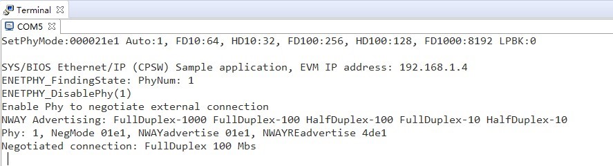

then we executed the gmake in the cmd window, when finished we import the project NIMU_BasicExample_icev2AM335x_armExampleproject and rebuild it.
after load the program and run we got the following result
It seems that the connection is successed, but the ping form our host computer is failed!
the program is shown as:
SOCCtrlCpswPortMacModeSelect(1, ETHERNET_MAC_TYPE_RMII);
SOCCtrlCpswPortMacModeSelect(2, ETHERNET_MAC_TYPE_RMII);
EMAC_socGetInitCfg(0, &cfg);
cfg.numPorts = 1;
cfg.port[0].phy_addr = 1;//EMAC_CPSW_PORT0_PHY_ADDR_ICE2;
//cfg.port[1].phy_addr = -1;//EMAC_CPSW_PORT1_PHY_ADDR_ICE2;
cfg.macModeFlags = EMAC_CPSW_CONFIG_MODEFLG_FULLDUPLEX| EMAC_CPSW_CONFIG_MODEFLG_IFCTLA;
EMAC_socSetInitCfg(0, &cfg);
I don't know why the ping is failed, please help me, thanks!
  • Hi voss,
    Just want to confirm that you execute this to have startware rebuilt, correct?
    Have you tried to dump the CPSW stat registers to check if any frame send/receive?
    Garrett
  • Thanks Garrett!
    The problem is solved.
    the reason is that we get two same boards, one is tested by uboot and linux, and it has no problem, so we think that the other is no problem too!
    unfortunately, there is problems in the other board which we run in RTOS envoriment. The PHY that we applied is DP83848, and it is not connect well with the board.
    after we adjusted it, it pass the ping test!
    thanks for the reply and
    best wishes!
