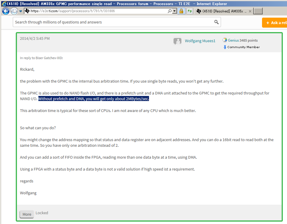

My customer need four or more data phase per access.
They built their own board and trying to access an FPGA. It is not successful.
Then, is there a sample code available for this access to show a proven procedure?
Or, could you please tell us a configuration to have the page mode access ?
  • Is it neccesary to use the FIFO in the GPMC subsystem? Is it possible to do that without DMA?
  • Is it necessary to use the DMA? Is it possible to do that without FIFO mentioned above?
