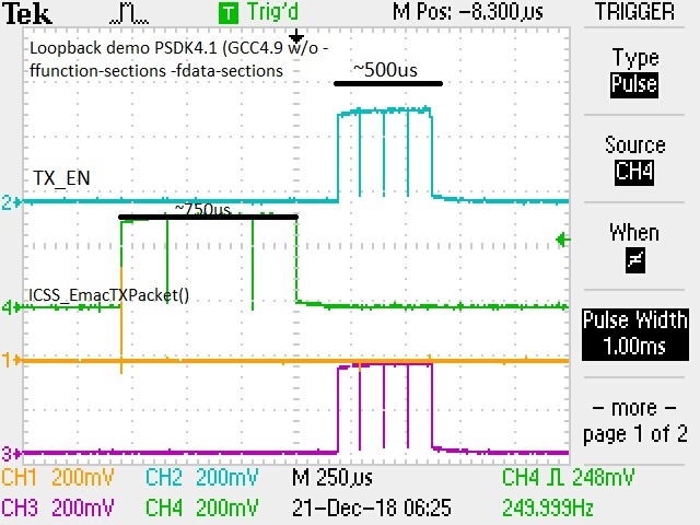

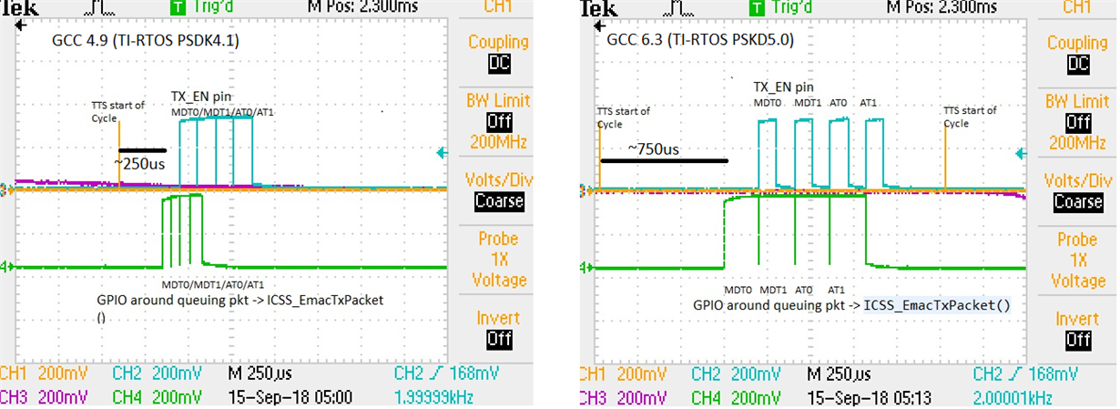

I noticed some functions were taking longer and happening later in time.. In other words, things seems to be slower. I originally thought this could be related to PDK changes, as the function I am profiling happens inside PRU-ICSS EMAC LLD. However, because I also see the function happening later, I am wondering if this is more related to newer GCC toolchain.

- Attaching a couple of scope snapshots to illustrate the issue.

  • Hi George another update , I did an experiment  with a simpler program. A packet loopback . I build the same code with PSDK4.1 and PSDK5.0 tools versions. And I don’t see any performance difference. For the sake of the experiment, I was profiling the same functions in the scope (same board as well).
    Then, I think this rule out it is a GCC version issue (or any other Processor SDK tool version). But maybe is it related to heap size? (as mentioned on this E2E)
    FYI, simple loopback program and my code, both exercise PRU-ICSS EMAC + TTS from AM335x PDK. I used same packet size for both codes, to keep queuing packets conditions as similar as possible.

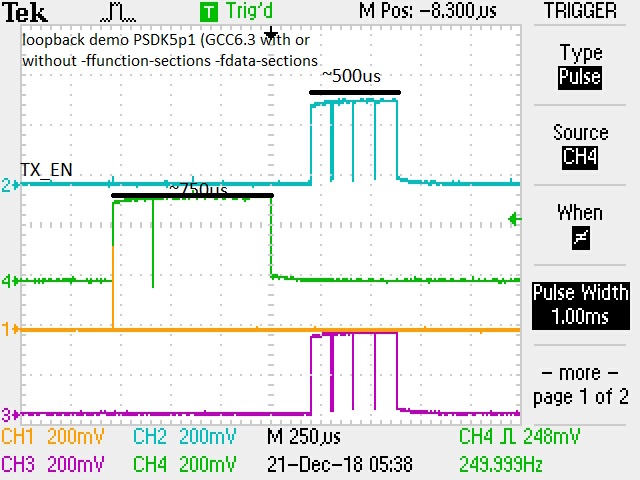

  • Hi George, I did some progress. Actually there is a performance difference between PSDK4.1 (GCC4.9) and PSDK5.0 (GCC6.3) tools if  "-ffunction-sections -fdata-sections"  are used.
    When creating my small loopback experiment, I missed to add those flags. My original application project uses them.
    Let me share some snapshots to illustrate my experiments
    Test1: loopback demo, built with PDSK4.1 tools. Without "-ffunction-sections -fdata-sections" optimizations
    Test2: loopback demo, built with PDSK4.1 tools. With "-ffunction-sections -fdata-sections" optimizations
    Test2 behaves similar  (similar time for queuing packets - green graphic) to my application when build with PSDK4.1 tools
    Test3: loopback demo, built with PDSK5.1 tools. With "-ffunction-sections -fdata-sections" optimizations
    Not improvements observed with

  • All, after some additional debugging and some tips from Linaro's team. We found out the issue was related to Memory functions (i.e., memcpy/memset) in "newlib-nano".
    "newlib-nano" is optimized for size and therefore performance could be reduced in some areas. In this "newlib-nano" Memory functions use byte-wise instead of word-wise.
    As a test, I changed memcpy() with a word-wise version found online inside ICSS_EmacTxPacketEnqueue(), and rebuilt PDK and application. Performance now is similar to TEST2 (PSDK4.1, GCC4.9).
