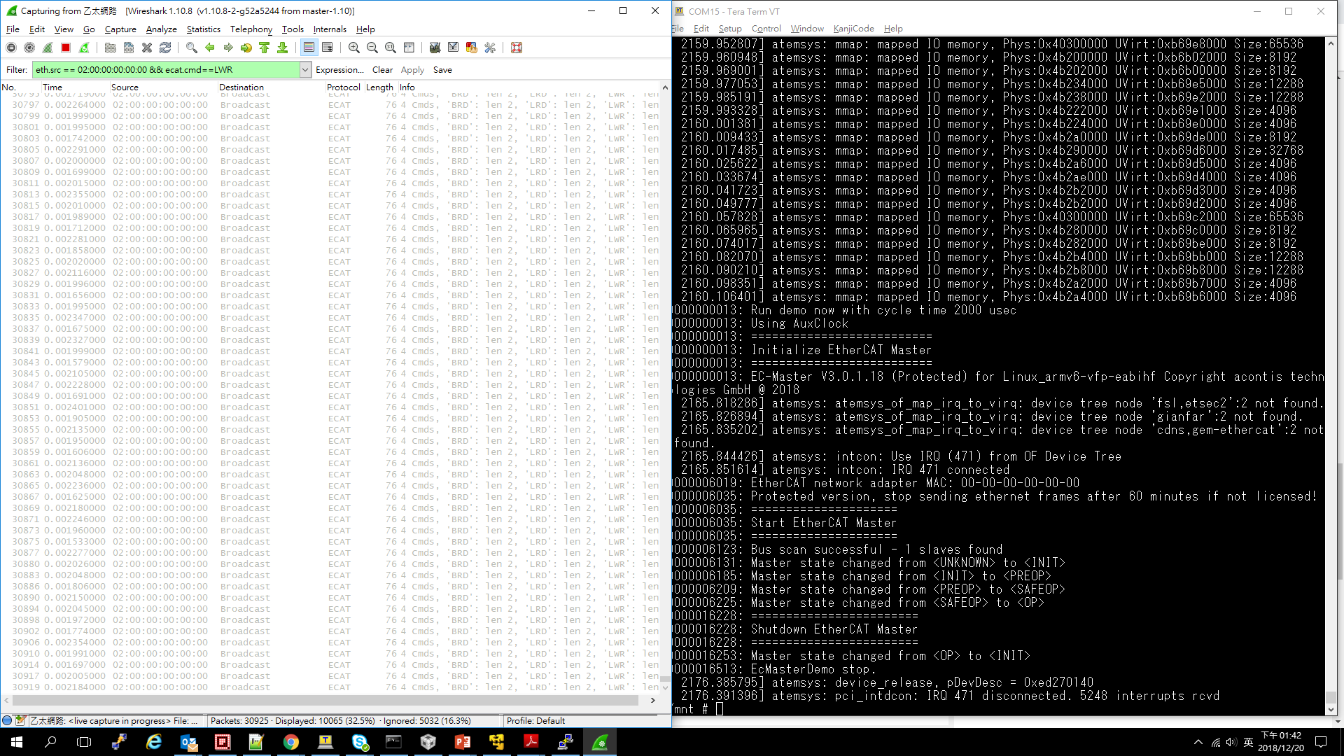

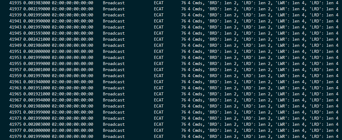

However, TTS does not help reduce jitters from "us" to "ns". I attached the result of jitters w/ and w/o TTS in the end. Can you please give some comments?
Hungwei
the result with TTS enabled:
the result with TTS disabled:

    >Which sniffer are you using?
    I use Wireshark v2.6.4 at first. I have changed to use Wirfeshark 1.10.8, but the result seems no different...
    >Which filter are you using?
    eth.src == 02:00:00:00:00:00 && ecat.cmd==LWR
    >could you please attach your wireshark?
    Please see the following picture.
    Hungwei

  • Hungwei, I opened your wiresharks and indeed jitter is big. I don't think a hub should be used. I don't think a hub can do "on the fly" processing main idea of EtherCAT technology, and not sure how fast and with which jitter ASUS hub forward the packets. In summary the jitter could be introduced there. Plus other questions, is this hub half-duplex? which speed uses? etc. I think in order to be sure of EtherCAT network jitter you need to use an industrial sniffer or TAP. I uses Beckhoff ET2000. Some colleagues have recommended me Kunbus 2100 TAP. Kunbus TAP is completely transparent to the packets, so it is even better and can work for different other industrial protocols. Beckhoff is not totally transparent, and add a small "ESL" information to the packets, but for EtherCAT it works great.
