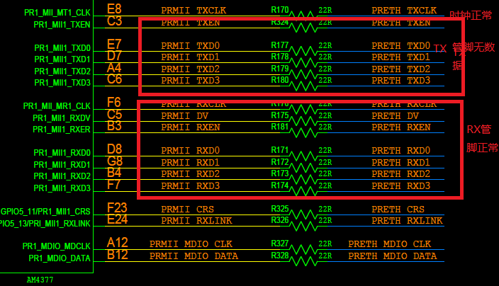

     The board designed by our company has two network ports, one is Gigabit ethernet. The network card chip KSZ9031 is connected to the rgmii1 interface of ARM4377. The mdio_clk and mdio_data are connected to B17 and A17 respectively and driven by CPSW. The network ports can work normally.
      Another way is that the network of PRU uses network card chip TLK105L to connect to pru1_mii1 interface of ARM am4377. Di_clk and mdio_data are connected to A12 and B12 respectively and driven by prueth. After the system starts, the network card can not be recognized. The serial terminal reports the following red part of the error:

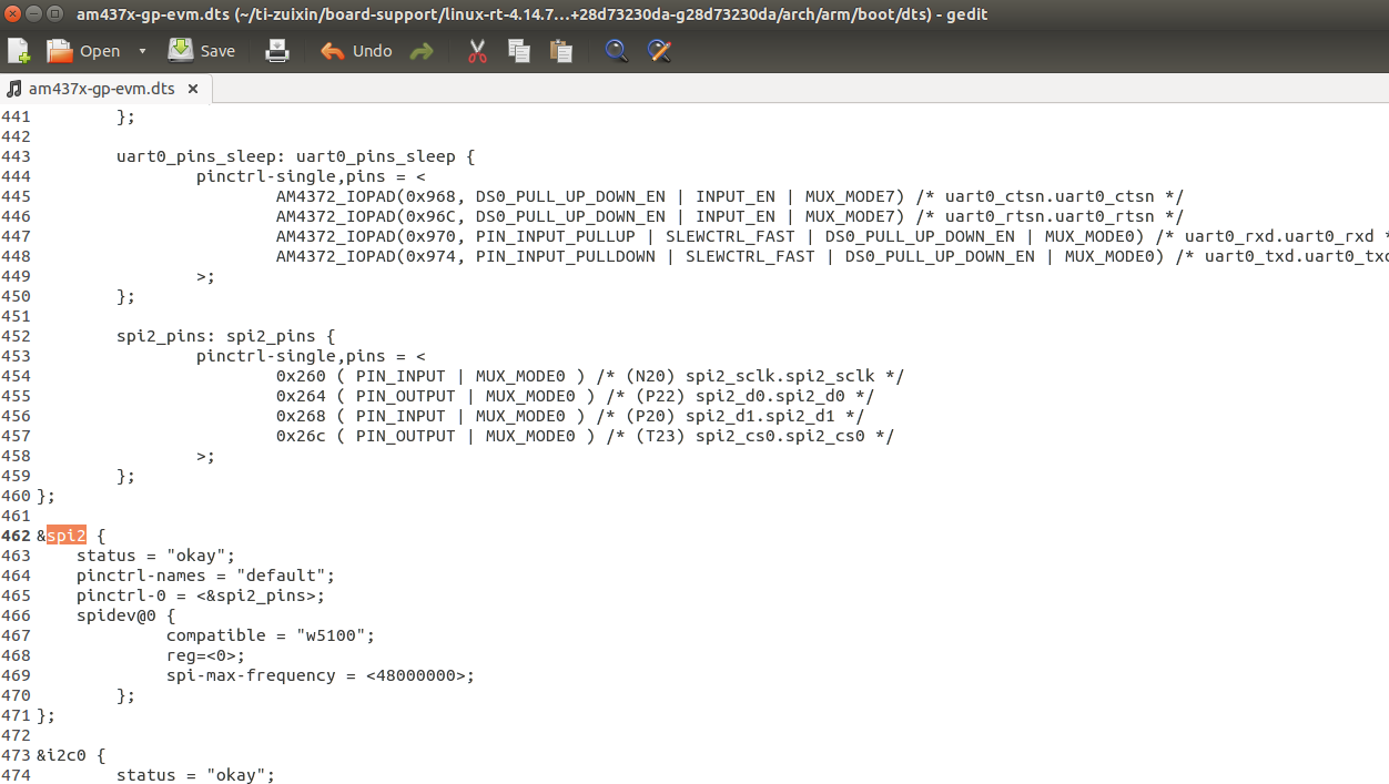

     Referring to TI's AM437X-IDK development board in the device tree, Pru network configuration is added. The Linux kernel uses the 4.4.12 RTLinux kernel. lsmod can see that Pru network related drivers have been loaded. The complete start-up log information and device tree configuration file for terminal printing can be found in the annex. Please help to analyze what may be the problem. Thank you very much.

Pru network configuration in am437x-gp-evm.dts device tree:
 pruss1_eth {
   compatible = "ti,am4372-prueth";
   pruss = <&pruss1>;
   sram = <&ocmcram_nocache>;
   interrupt-parent = <&pruss1_intc>;
   pinctrl-0 = <&pruss1_eth_default>;
   pinctrl-names = "default";
   pruss1_emac0: ethernet-mii0 {
    phy-handle = <&pruss1_eth0_phy>;
    phy-mode = "mii";
    interrupts = <20>, <22>;
    interrupt-names = "rx", "tx";
    /* Filled in by bootloader */
    local-mac-address = [00 00 00 00 00 00];
pruss1_eth_default: pruss1_eth_default {
   pinctrl-single,pins = <
   0x58 ( PIN_INPUT | MUX_MODE5 ) /* (E8) gpmc_a6.pr1_mii_mt1_clk */
   0x54 ( PIN_OUTPUT | MUX_MODE5 ) /* (E7) gpmc_a5.pr1_mii1_txd0 */
   0x50 ( PIN_OUTPUT | MUX_MODE5 ) /* (D7) gpmc_a4.pr1_mii1_txd1 */
   0x4c ( PIN_OUTPUT | MUX_MODE5 ) /* (A4) gpmc_a3.pr1_mii1_txd2 */
   0x48 ( PIN_OUTPUT | MUX_MODE5 ) /* (C6) gpmc_a2.pr1_mii1_txd3 */
   0x6c ( PIN_INPUT | MUX_MODE5 ) /* (D8) gpmc_a11.pr1_mii1_rxd0 */
   0x68 ( PIN_INPUT | MUX_MODE5 ) /* (G8) gpmc_a10.pr1_mii1_rxd1 */
   0x64 ( PIN_INPUT | MUX_MODE5 ) /* (B4) gpmc_a9.pr1_mii1_rxd2 */
   0x60 ( PIN_INPUT | MUX_MODE5 ) /* (F7) gpmc_a8.pr1_mii1_rxd3 */
   0x40 ( PIN_OUTPUT | MUX_MODE5 ) /* (C3) gpmc_a0.pr1_mii1_txen */
   0x5c ( PIN_INPUT | MUX_MODE5 ) /* (F6) gpmc_a7.pr1_mii_mr1_clk */
   0x44 ( PIN_INPUT | MUX_MODE5 ) /* (C5) gpmc_a1.pr1_mii1_rxdv */
   0x74 ( PIN_INPUT | MUX_MODE5 ) /* (B3) gpmc_wpn.pr1_mii1_rxer */
   0x24c (PIN_INPUT | MUX_MODE5 ) /* (E24) gpio5_13.pr1_mii1_rxlink */
   0x244 (PIN_INPUT | MUX_MODE5 ) /* (F23) gpio5_11.pr1_mii1_crs */
pruss1_mdio_default: pruss1_mdio_default {
   0x8c ( PIN_OUTPUT | MUX_MODE5 ) /* (A12) gpmc_clk.pr1_mdio_mdclk */
    0x88 ( PIN_INPUT | MUX_MODE5 ) /* (B12) gpmc_csn3.pr1_mdio_data */
   0x248( PIN_INPUT_PULLUP | MUX_MODE7)     /* gpio5_12 */
& pruss1_mdio {
pinctrl-0 = <&pruss1_mdio_default>;
status = "okay";
reset-gpios = <&gpio5 12 GPIO_ACTIVE_LOW>;
reset-delay-us = <2>; /* PHY datasheet states 1uS min */
pruss1_eth0_phy: ethernet-phy@0 {
   reg = <0>;
Pru network configuration in am4372.dtsi device tree:

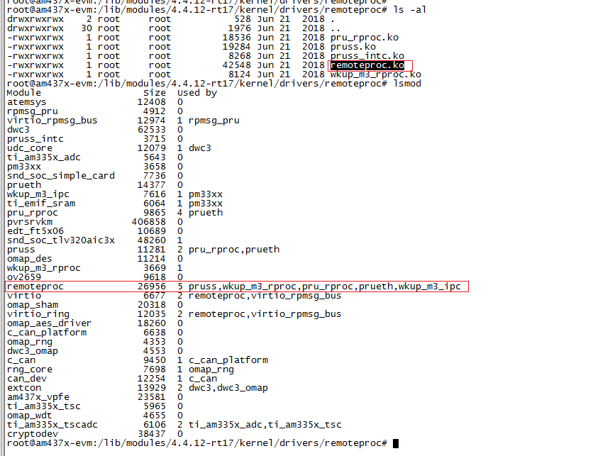

root@am437x-evm:~# lsmod
Module                  Size  Used by
atemsys                12408  0
pvrsrvkm              406858  0
dwc3                   62533  0
udc_core               12079  1 dwc3
pm33xx                  3658  0
ti_am335x_adc           5643  0
ti_am335x_tsc           5965  0
snd_soc_simple_card     7736  0
prueth                 14377  0
ti_emif_sram            6064  1 pm33xx
wkup_m3_ipc             7616  1 pm33xx
snd_soc_tlv320aic3x    48260  1
pru_rproc               9865  1 prueth
omap_rng                4353  0
am437x_vpfe            23581  0
edt_ft5x06             10689  0
omap_aes_driver        18260  0
rng_core                7698  1 omap_rng
ov2659                  9618  0
pruss                  11281  2 pru_rproc,prueth
dwc3_omap               4553  0
omap_des               11214  0
extcon                 13929  2 dwc3,dwc3_omap
wkup_m3_rproc           3669  1
remoteproc             26956  5 pruss,wkup_m3_rproc,pru_rproc,prueth,wkup_m3_ipc
virtio                  6677  1 remoteproc
virtio_ring            12035  1 remoteproc
omap_sham              20318  0
c_can_platform          6638  0
c_can                   9450  1 c_can_platform
can_dev                12254  1 c_can
cryptodev              38437  0
ti_am335x_tscadc        6106  2 ti_am335x_adc,ti_am335x_tsc
omap_wdt                4655  0

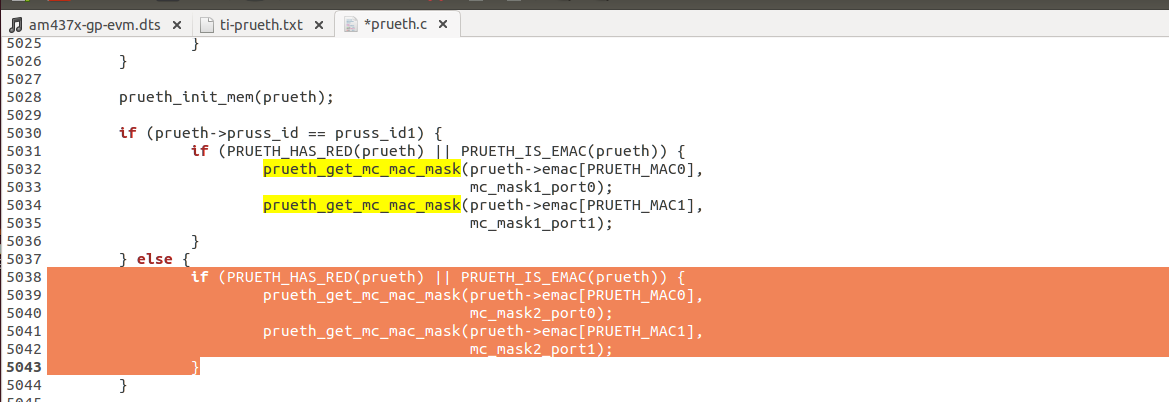

  • It should have been verified on the AM437x IDK that it was working at the time. If you have an AM437x IDK, you could use that as your template for testing.
    The errors you are seeing are coming from the prueth_probe function in the prueth driver located at drivers/net/ethernet/ti/prueth.c. I expect that you have some problems with your device tree entry. For example, it looks like the driver is looking for a ethernet-mii1 subnode in the device tree, but cannot find it.
    Nick

            Hardware Engineer have been looking for problems a few days ago, and then re-welded the TLK105L phy chip. Now the start-up can be swept to the TLK PHY chip, as follows, see the attachment for the detailed log:

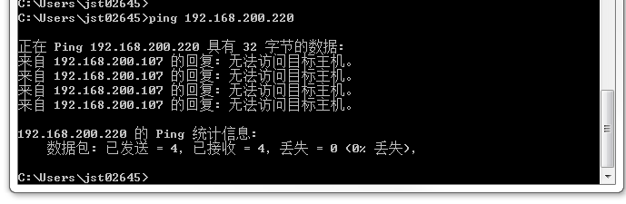

  •  Hello Nick,
             pru network has been able to run normally, as follows log, but the network on the computer Ping Pru network eth1 IP and on board Ping computer IP Ping is not working.Please help to see what may be the problem. Thank you very much.

    root@am437x-evm:~# ifconfig eth1 192.168.200.220
    [   38.158071] net eth1: started
    [   38.161181] IPv6: ADDRCONF(NETDEV_UP): eth1: link is not ready
    root@am437x-evm:~# [   39.216169] eth1: Link is Up - 100Mbps/Full - flow control rx/tx
    [   39.222229] IPv6: ADDRCONF(NETDEV_CHANGE): eth1: link becomes ready
    eth0      Link encap:Ethernet  HWaddr A0:F6:FD:1B:77:68
              inet addr:192.168.200.99  Bcast:192.168.200.255  Mask:255.255.255.0
              UP BROADCAST MULTICAST  MTU:1500  Metric:1
              RX packets:0 errors:0 dropped:0 overruns:0 frame:0
              TX packets:0 errors:0 dropped:0 overruns:0 carrier:0
              collisions:0 txqueuelen:1000
              RX bytes:0 (0.0 B)  TX bytes:0 (0.0 B)
              Interrupt:205
    eth1      Link encap:Ethernet  HWaddr 2A:7E:FC:85:08:02
              inet addr:192.168.200.220  Bcast:192.168.200.255  Mask:255.255.255.0
              inet6 addr: fe80::287e:fcff:fe85:802/64 Scope:Link
              UP BROADCAST RUNNING MULTICAST  MTU:1500  Metric:1
              TX packets:8 errors:0 dropped:0 overruns:0 carrier:0

    root@am437x-evm:~# ping 192.168.200.107&
    root@am437x-evm:~# PING 192.168.200.107 (192.168.200.107): 56 data bytes
    TLK105L hardware test found that TX pin has no data, RX pin data is normal.

    Ping the eth1 IP 192.168.200.220 Ping network card is not available as fllows

  • Hello Nick,
    Today I according to PRU-ICSS Remoteproc and RPMsg(http://processors.wiki.ti.com/index.php/PRU-ICSS_Remoteproc_and_RPMsg, I found that the remoteproc directory did not appear under /sys/class. Is my PRU core not activated?
    remoteproc.ko exists in the directory kernel/drivers/remoteproc as follows,and lsmod found remoteproc has been loaded.
    The files in lib/firmware are as follows.

    Ethernet:
    1) Please confirm: There are only two PHYs on your board: KSZ9031 which connects to the CPSW, and TLK105L which connects to pru1_mii1. I am researching if single EMAC functionality was enabled for PRUETH in Linux 4.4, or if it was limited to dual EMAC use cases - I do know there have been many other bug fixes and added features in later versions of Linux.
    2) I expect that ethernet-phy@0 should have reg=<0> and ethernet-phy@1 should have reg=<1>. Is there a reason why you flipped them?

    1)I confirm our board only two PHYs on your board: KSZ9031 which connects to the CPSW, and TLK105L which connects to pru1_mii1. As you said, I saw your TI IDK card and other companies IDK card are two routes of Pru network.Thank you very much for your help me to verify  if single EMAC functionality was enabled for PRUETH in Linux 4.4, or if it was limited to dual EMAC use cases.I will be anxious to wait for your verification results.
    And I'm not sure if the following mistakes have any impact.
    [    7.696754] prueth pruss1_eth: port 1: using random MAC addr: 76:ba:74:01:40:51
    [    7.776184] prueth pruss1_eth: port 2: using random MAC addr: 32:9b:e6:9a:94:b7
    [    7.776219] prueth pruss1_eth: couldn't connect to phy /ocp/pruss@54400000/mdio@54432400/ethernet-phy@1
    [    7.776236] prueth pruss1_eth: netdev init ethernet-mii1 failed: -19
    [    7.777143] prueth pruss1_eth: TI PRU ethernet driver initialized
    2)Our board TLK105L COL pins are not connected,so the default address is 0x01,We verify that the pin address of the connection col has been changed to 0x0, but the current problem still exists.

  • TI does not support single port operation for PRUETH on Linux 4.4. We added single port operation for PRUETH in Linux 4.14 (Processor Linux SDK 5.0 or later).   EDIT 2019-05-17: Linux SDK 5.3 or later.
    The TI suggested solution is to upgrade to a more recent version of Linux in order to enable single port operation and benefit from other features and bug fixes.
    If you cannot upgrade to a more recent version of Linux, it makes more sense to cherry pick the patches that add support for single port operation rather than trying to hack the driver. I found the attached patches to backport single port operation to Linux 4.9. In your dts/dtsi files, you would want to delete the second pruss emac node and pruss phy node since you only have one phy attached to the PRU-ICSS rather than 2 phys.
    Note: I will not be able to help you in the backporting process if you go that way.

    [   15.655758] PC is at prueth_get_mc_mac_mask+0x14/0x8c [ti_prueth]
    [   15.655781] LR is at prueth_probe+0x768/0x80c [ti_prueth]
    [   15.656040] [<bf155400>] (prueth_get_mc_mac_mask [ti_prueth]) from [<bf155bf4>] (prueth_probe+0x768/0x80c [ti_prueth])
    [   15.656085] [<bf15548c>] (prueth_probe [ti_prueth]) from [<c0534564>] (platform_drv_probe+0x58/0xb4)
    [   15.656202] [<c0534474>] (__platform_driver_register) from [<bf16601c>] (prueth_driver_init+0x1c/0x1000 [ti_prueth])
    [   15.656234] [<bf166000>] (prueth_driver_init [ti_prueth]) from [<c0101794>] (do_one_initcall+0x4c/0x170)
    root@am437x-evm:~#

  • Hello Nanfeng,
    Please take a look at the second example in the Linux 4.14 bindings documentation in Documentation/devicetree/bindings/net/ti-prueth.txt for guidance on modifying the device tree node for single-emac operation. it looks like you should only list one firmware-name, there might be other changes to make as well.
    Nick
  • Hello Nick,
    Thank you very much for your response.
    I modified the device tree file node for single-emac operation according to /devicetree/bindings/net/ti-prueth.txt,but the problem remains. Complete printing of log and device tree files in the attachment,Could you help me see if there are any other errors in the device tree?Thank you very much.
    [   14.562710] davinci_mdio 54432400.mdio: phy[0]: device 54432400.mdio:00, driver TI TLK10X 10/100 Mbps PHY

    gdb cannot be performed in file system arago-base-tisdk-image-am437x-evm.tar,As in the previous log, I found that the crash was caused by the function prueth_get_mc_mac_mask.
    [   15.791247] PC is at prueth_get_mc_mac_mask+0x14/0x8c [ti_prueth]
    [   15.791270] LR is at prueth_probe+0x75c/0x80c [ti_prueth]
    And I found that prueth_get_mc_mac_mask was called twice in the function prueth_probe. Should prueth_get_mc_mac_mask be called twice when it is set to single-emac?
    I modified prueth. c code to rebuild ti-prueth. ko as shown in the following picture:
    New problems arise as shown in the following log:

    This may be a driver bug that was introduced between SDK 5.0 and SDK 5.2 - that code that is causing issues was added after SDK 5.0, and the last time I have verification that single EMAC was tested was 5.0. I'm digging around some more on this end.
    Do you get the same results when you change the driver as below?
            if (prueth->pruss_id == pruss_id1) {
                    if (PRUETH_HAS_RED(prueth) || PRUETH_IS_EMAC(prueth)) {
                            if (eth0_node) {
                                    prueth_get_mc_mac_mask(prueth->emac[PRUETH_MAC0],
                                                   mc_mask1_port0);
                            if (eth1_node) {
                                    prueth_get_mc_mac_mask(prueth->emac[PRUETH_MAC1],
                                                   mc_mask1_port1);
            } else {
                            if (eth0_node) {
                                                   mc_mask2_port0);
                            if (eth1_node) {
                                                   mc_mask2_port1);
            dev_info(dev, "pruss_fw_drop_untagged_vlan %d\n",
                     prueth->fw_drop_untagged_vlan);
            if (eth0_node) {
            dev_info(dev, "pruss MC Mask (Port 0) %x:%x:%x:%x:%x:%x\n",
                     prueth->emac[PRUETH_MAC0]->mc_mac_mask[0],
                     prueth->emac[PRUETH_MAC0]->mc_mac_mask[1],
                     prueth->emac[PRUETH_MAC0]->mc_mac_mask[2],
                     prueth->emac[PRUETH_MAC0]->mc_mac_mask[3],
                     prueth->emac[PRUETH_MAC0]->mc_mac_mask[4],
                     prueth->emac[PRUETH_MAC0]->mc_mac_mask[5]);
            if (eth1_node) {
            dev_info(dev, "pruss MC Mask (Port 1) %x:%x:%x:%x:%x:%x\n",
                     prueth->emac[PRUETH_MAC1]->mc_mac_mask[0],
                     prueth->emac[PRUETH_MAC1]->mc_mac_mask[1],
                     prueth->emac[PRUETH_MAC1]->mc_mac_mask[2],
                     prueth->emac[PRUETH_MAC1]->mc_mac_mask[3],
                     prueth->emac[PRUETH_MAC1]->mc_mac_mask[4],
                     prueth->emac[PRUETH_MAC1]->mc_mac_mask[5]);
    If that still gives the kernel oops from  emac_ndo_set_features, it would help if you could narrow down the line causing the issue - maybe with printks in the driver, or a tool like arm-linux-gnueabihf-addr2line if you can get it working?
    Nick
