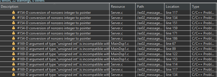

I have been trying to implement the custom MessageQ application provided by the linked question; Sahin's personal versions of the ARM and DSP projects. I was able to get them to build after awhile, making some of the adjustments mentioned in the thread as well.
My issue is with the output of the programs, I get no output to console or serial terminals. I believe the log_print0/log_print1 are Linux commands, but the target OS for both cores is supposed to be TI-RTOS. I've tried using printf and system_printf()/system_flush(), but neither of those worked when adding the information required to the .cfg file. (as suggested here: ).
I get 154-D and 169-D errors:
I can launch the binaries to the cores but I can't tell what's happening unless I step through. The print statements would be better for a general purpose use-case. Please assist me in getting the statements to print to serial terminal.

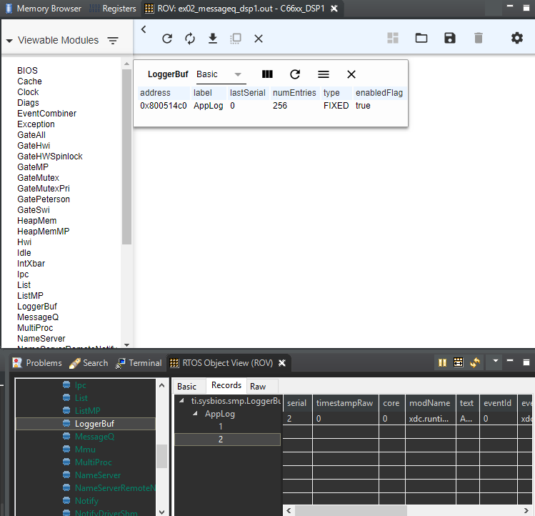

    You can view the output of the log_prints in ROV by going to Tools -> ROV Classic -> LoggerBuf module -> Records tab.

    Thanks for the quick reply. I am trying to access the ROV Classic View but my RTSC is not properly pathed for this tool. Can you please assist in the setup of this window:
    This appears to be a general CCS setting, so I am not sure how I should set it up.
    Thanks again for your assistance.
    Alec
  • So I guess the setting in the window I pasted was sufficient.
    I will assume this output is correct until I have looked into this more.
    Thanks for your assistance, Sahin.
