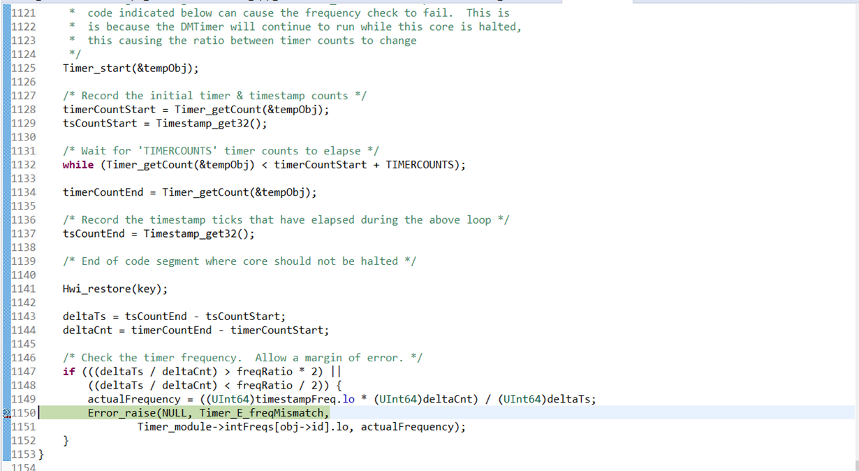

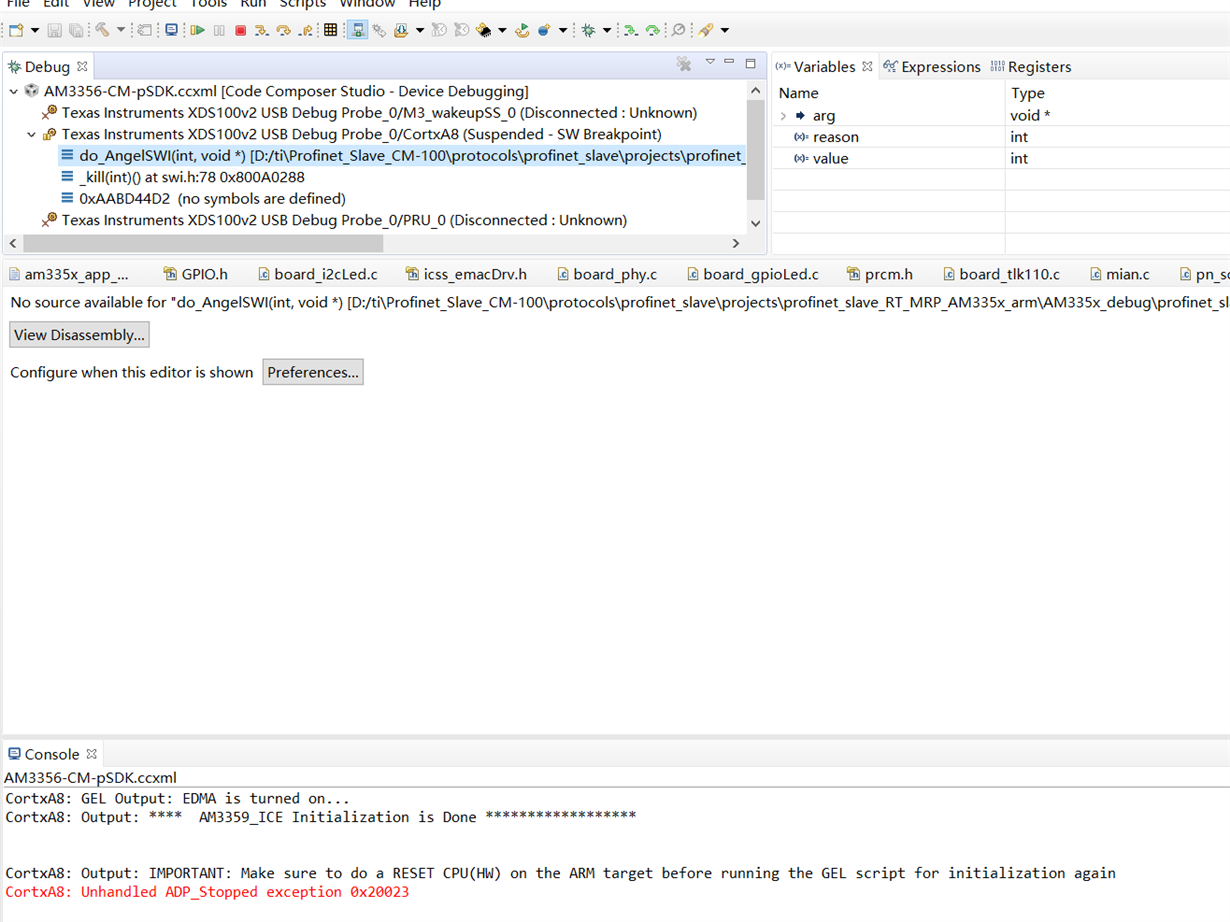

I ported the PROFINET Demo to my own AM3356 board.I modified the GEL file and used my repository(DDR size and frequency is different).So "I2C_Example_icev2AM335x_armExampleProject" is OK on my board.
And the momory allocation fails.I don't know if it is caused by the same problem. By the way, DMTimer4 is enabled in GEL file.
Please give me some thought !!
