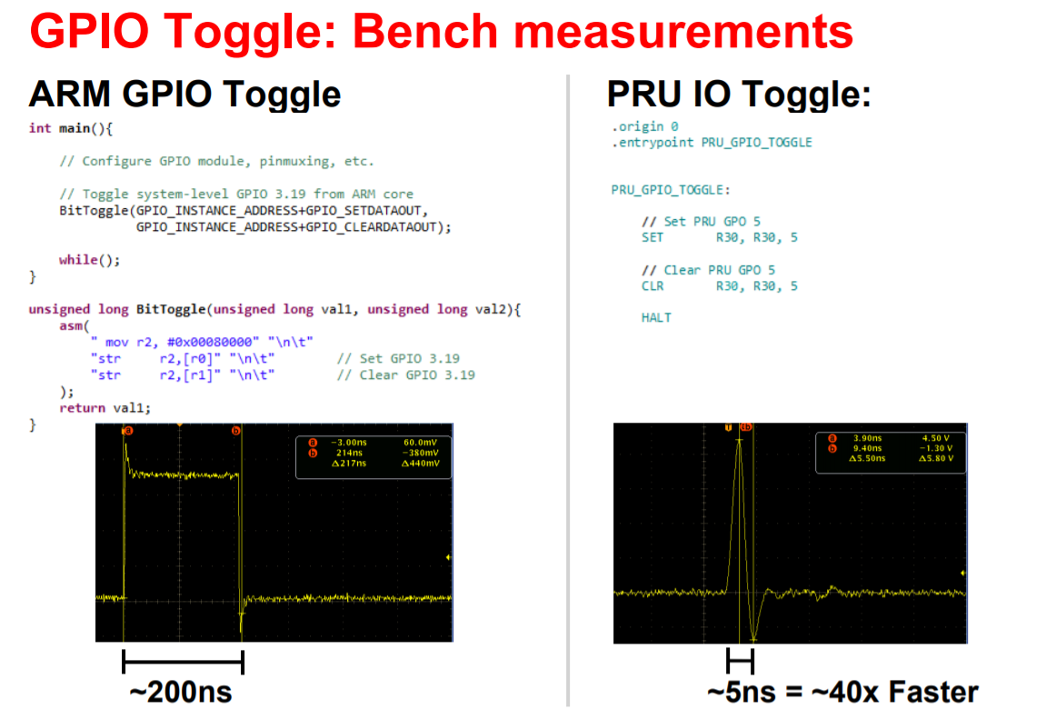

AM5728 response time.
I want GPIO response as quick as possible .
My requirement is GPIO should respond  1 micro sec( Min) and 10 Milli Sec (max).
Response time is depends on OS/RTOS ? Please suggest which RTOS/OS need to use for quick response.
Do you have any timing diagram for GPIO response time.
Thank you
  • Srinivas,
    We have compared the latency of ARM(cortex A8) toggling a GPIO and PRU`s toggling the GPIO  in the past. based on that effort both the cores should be able to meet your requirement. I am providing it for your reference:
    the number were calculated using bare-metal (no OS code) but you could also run TI RTOS. On AM5728,  you have multiple cores that will meet this requirement.
