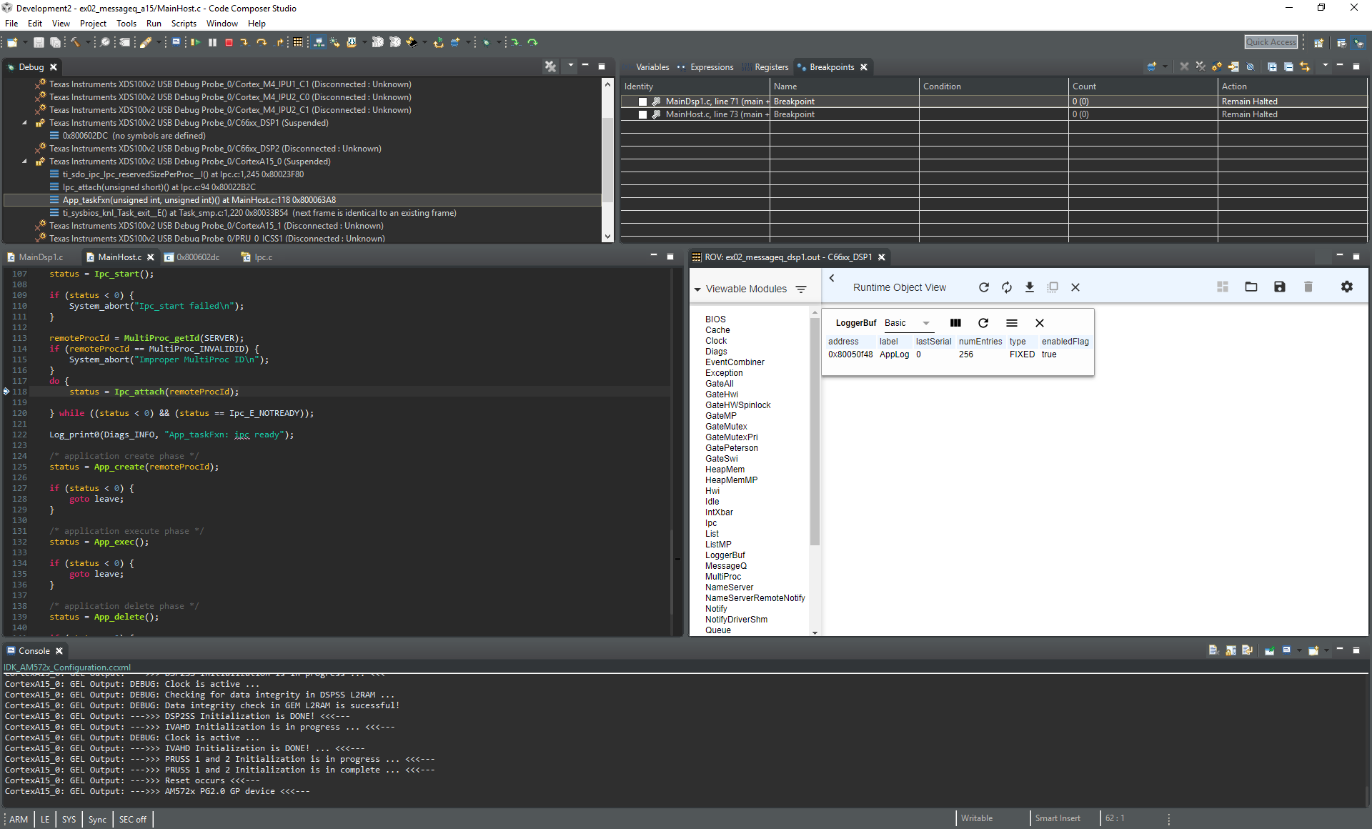

    The problem is I'm not able to step through. The projects build, I load the .out to the correct cores, and run the example. I let it sit for awhile and nothing happens.
    I've tried setting breakpoints in both the MainHost and MainDsp1 source files. First one is in main() and second one is in App_taskFxn(). The first one gets hit for both cores.
    1. For MainHost.c, I am able to continue to step through until I reach the [do -> while] loop (~Line 117). Because the RemoteProcID never gets set, it gets stuck in an infinite loop.
    2. For MainDsp1, I hit the first breakpoint in main() at Task_Params_Init(&taskParams) (~Line 70). If I step through, resume, or do anything to try to pass this breakpoint, the core gets held up.
    The memory location that the DSP gets stuck is around 0x8000_0000 every time.
    I will attempt to use some of the debugging techniques you've shared, but if you could address my issue more specifically, it'd be a lot more helpful for me.

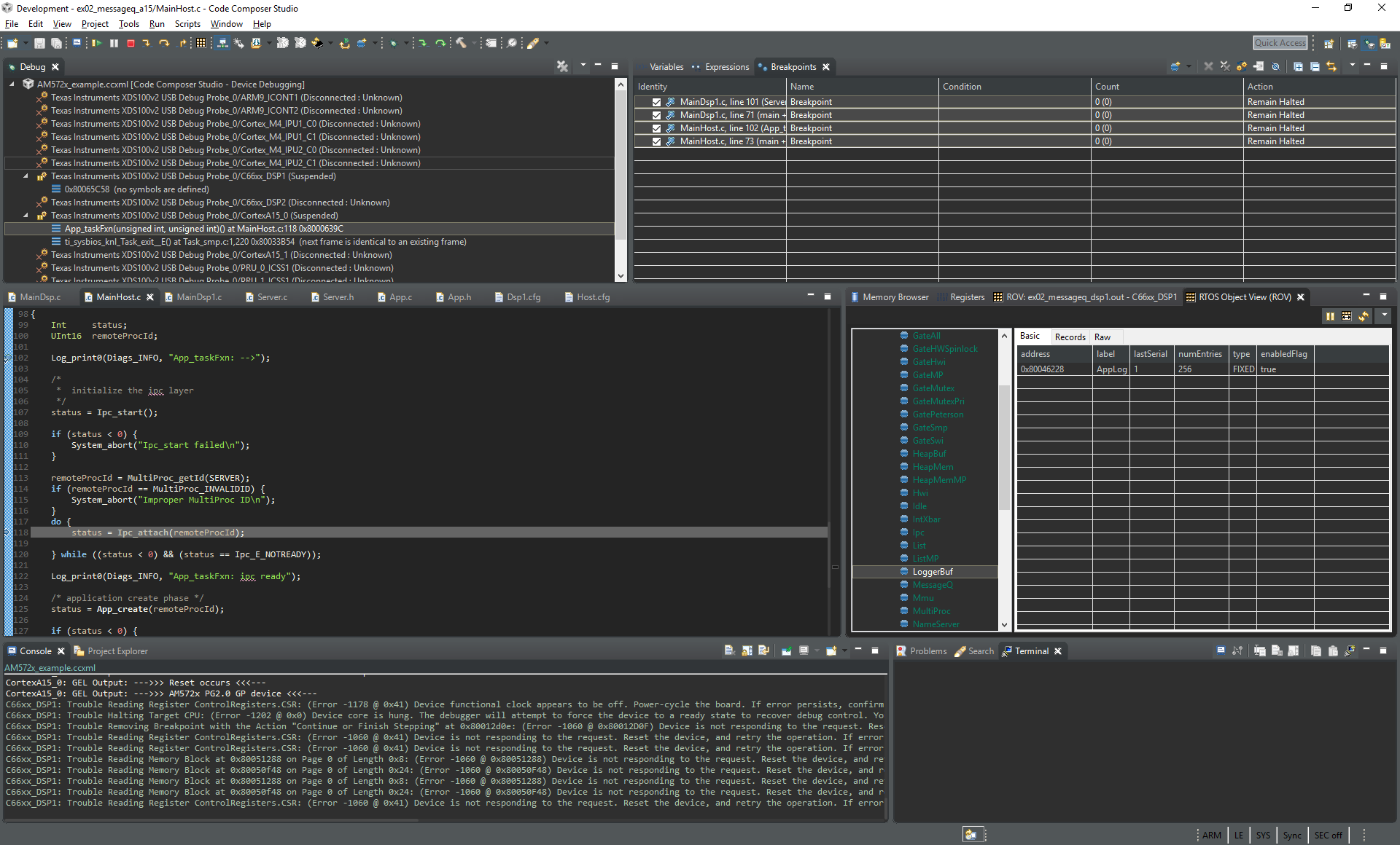

  • Hi Sahin,
    The cores are still hanging for me. Both cores will hang, depending on which one I execute first (I believe).
    Arm runs, DSP Fails:
    DSP Runs, ARM fails:
    I'm using a fresh workspace, I checked the pathing for both projects; everything seems fine.
    Hard to debug this one, can't make it out of main(). Have you tried running the project recently? Could a newer version of IPC be a possible issue?
    Thank you,
    Alec
