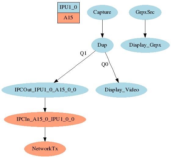

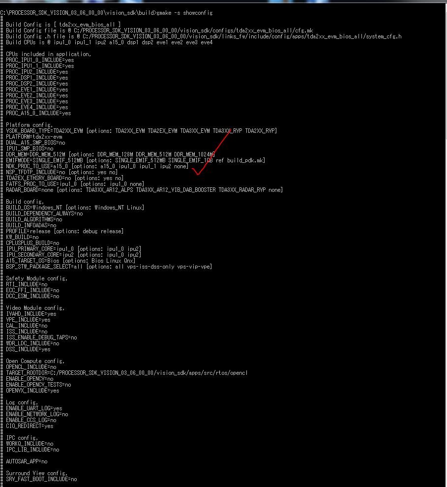

i am using tda2x/PROCESSOR_SDK_VISION_03_06_00_00.After install and build,starting run the usecase--"1CH VIP Capture + Network TX".
oh,my evm board ip address is static --192.168.1.200,and pc side is 192.168.1.201.And network cable was connected to EVM board side P5 port.

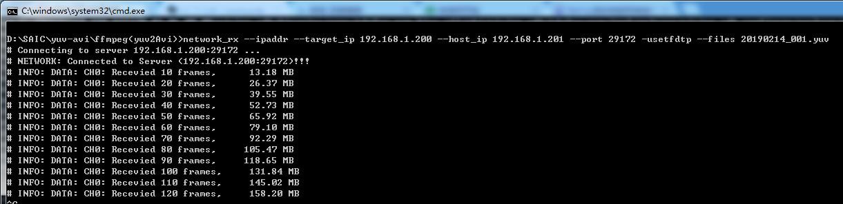

And then,running the command in windows cmd terminal.
"network_rx --ipaddr --target_ip 192.168.1.200 --host_ip 192.168.1.201 --port 29172 -usetfdtp --files 20190214_001.yuv"
          my problem is the speed of network.Less than 1280*720  30fps.just about 10fps.
How to improve the speed of network?thank you.
