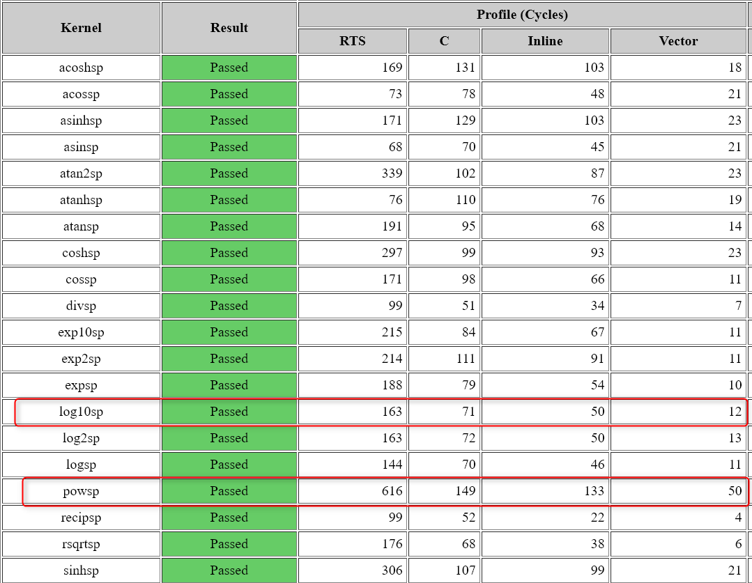

  • Hello!
    The first thought is to consider mathlib. It provides faster implementations of those functions, as well as their vector versions.
  • Matusan,
    I second the suggestion from rrlagic. Powf and log10 are functions that are defined in the C6000 Compiler RTS library.  If those functions need to be accelerated, then you can either choose to replace them with MATHLIB functions  or rebuild the library to override RTS library.
    The performance benefit from using this library is documented here:
    If you build the library in OVERRIDE_RTS mode, then the application code doesn`t need to be changed to take advantage of the performance benefit from MATHLIB.
    Rahul

  • Nomo,
    the wiki article that you posted describes, how to rebuild the C6000 Compiler RTS library and not MATHLIB.  To rebuild mathlib, you need to use instructions here:
    There are makefile .mk in the folder path mathlib_c66x_3_1_1_0\packages\ti\mathlib\lib. The .mk files define -d OVERRIDE_RTS=0 in KERNELC66CFLAGS which can be changed to OVERRIDE_RTS=1. Build process is described in the MATHLIB_Users_Manual.html in the docs folder.  I am not using CCS projects for rebuilding. I built it using make file at location in the package packages\ti\mathlib. you need to set some paths at the top of the makefile and invoke the make <target>
    I have prebuilt the mathlib for you, which you can use. you need to change the link order to link this library before RTS library:
    AM57xx_C66x_Benchmark_Package (2).zip
    Hope this helps.
