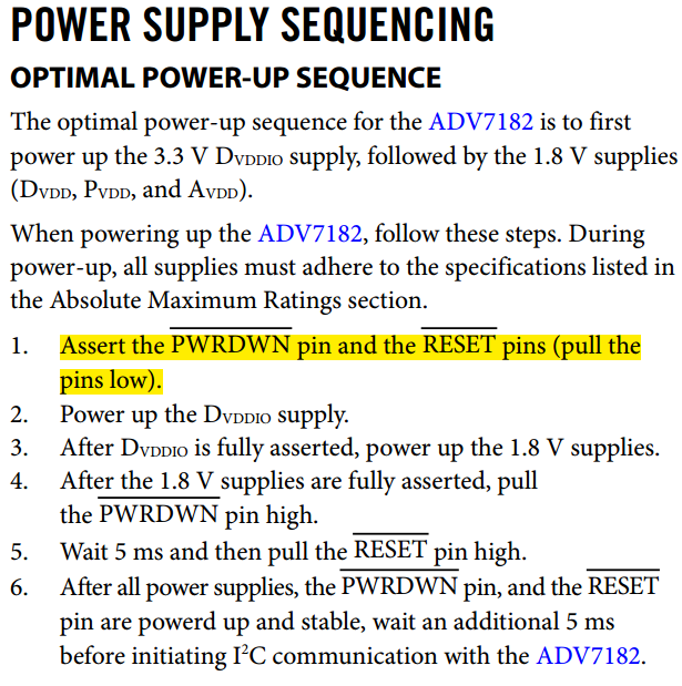

    thanks for your reply, i had check the adv7182 data sheet carefully, the power sequence as following:
    and i have use voltmeter to measure the voltage of PWRDWN and RESET pin, both of them are high level.

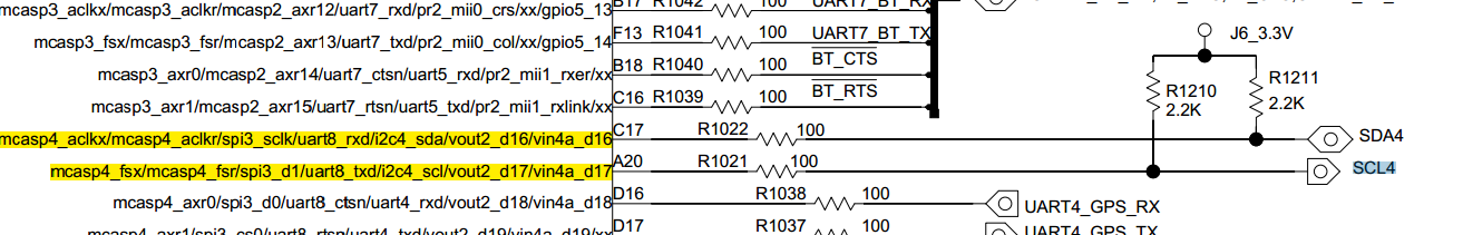

    and adv7182 chip I2C is connected to SDA4 and SCL4, the index is start from 1, so i think in vision SDK it is relate to the I2C instance 3.
    i also check the MCASP4 ACLKX and FSX pin mux value, both of them is 0x50004, log as following:
    [HOST] [IPU2  ]     40.171109 s: (1)MCASP4_ACLKX:MuxAddr = 0x4a003734, MuxVal = 0x50004
    [HOST] [IPU2  ]     40.171231 s: (1)MCASP4_FSX:MuxAddr = 0x4a003738, MuxVal = 0x50004

    I2C4_sda and I2C4_scl pins would be connected on multiple pads of the soc with different mux modes.
    Make sure that in other pads, the mix mode is not selected for the I2C4 functionality.
    Can you probe the i2c pins when you are sending the commands to the slave (may be through a I2C signal analyzer).

    Check if the voltage and timing requirements for powering on device are taken care of.
