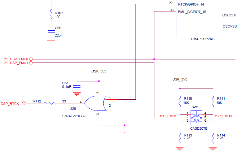

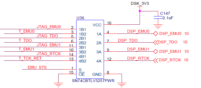

Hi, I'm designing a card with the C6747. I looked at the data sheet and the technical manual and it is not clear to me what to do with EMU[0] signal. Do I force it to 1 on the board to use an emulated?
What value during regular processing? What Emulator does TI recommend for the C6747? Based on other posts, if the Emulator header has emu[1] on it but the C6747 doesn't, do I leave it as a no connect?
Thank You, Tony
