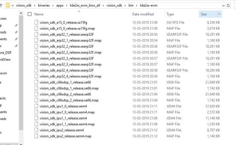

4.>>then i ran it using gmake commands and compilation was successful, the binaries are generated as in the image attached

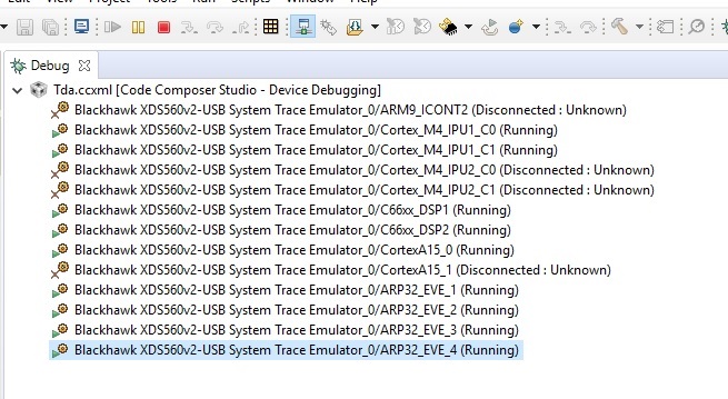

5. Now  as the guide mentions that load the binaries as
On ARP32_EVE_4, load the binary, “vision_sdk_arp32_4_release.xearp32F”.
On ARP32_EVE_3, load the binary, “vision_sdk_arp32_3_release.xearp32F”.
On ARP32_EVE_2, load the binary, “vision_sdk_arp32_2_release.xearp32F”.
On ARP32_EVE_1, load the binary, “vision_sdk_arp32_1_release.xearp32F”.
On C66xx_DSP2, load the binary, “vision_sdk_c66xdsp_2_release.xe66”.
On C66xx_DSP1, load the binary, “vision_sdk_c66xdsp_1_release.xe66”.
On Cortex_M4_IPU1_C0, load the binary, “vision_sdk_ipu1_0_release.xem4”.
On Cortex_M4_IPU1_C1, load the binary, “vision_sdk_ipu1_1_release.xem4”.
On CortexA15_0, load the binary, "vision_sdk_a15_0_debug.xa15fg”
And the line  "On CortexA15_0, load the binary, "vision_sdk_a15_0_debug.xa15fg” mentions that debug.xa15g  but the gmake has generated it as  "vision_sdk_a15_0_release.xa15fg.
Are they both same?

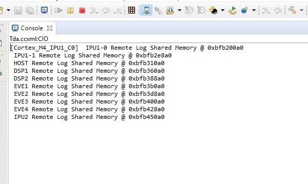

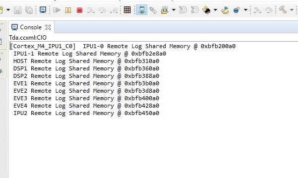

6. After loading the respective files on respective cores, Should i run the cores one by one or in a sequence or any other way.
7. do we have to connect and load the IPU2_0 & IPU2_1 cores also?
