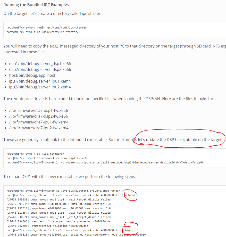

    I'm trying to think of any changes I made. When I ran the MessageQ application following the instructions, there was a change made to the DSP launch target.
    Could this be the issue?

    The only change I made to the SD card file system is what was shown in the screenshot. Is there a way to fix this without rebuilding the entire SDK? Is the original version of the dra7-dsp1-fw.xe66 located anywhere else on the disk so I can replace the one I modified? I did a search and found /usr/lib/opkg/alternatives/ has the file, but I don't know if there's a difference between it and the one in /lib/firmware/. I do not see the file in /lib/firmware/ipc/. The 4 files in that directory are "ti_platforms_evmDRA7XX_" dsp1, dsp2,ipu1,ipu2.

  • I back-tracked my steps in the example. I saw what the other cores were linked to, reassigned the Linked file in /lib/firmware/, unbound and bound the DSP core. Now I'm getting the _wait_target_disable warning for DSP1 core. I tried running the MessageQBench pre-built binary, but it still is not doing anything. And I targeted ProcID 4, as you suggested earlier.
    Please let me know if there's anything else I can try before going back to the Ubuntu system.

    dra7-dsp1-fw.xe66 is a link to dra7-dsp1-fw.xe66.opencl-monitor in the default setup for other demo. You only removed the link to it. You can always restore it by "ln -sf" command to link it back. the dsp1 opencl-monitor binary is in the same folder. In the worst case, you can always copy it from the filesystem in the PLSDK release. Just untar the tisdk-rootfs-image-am57xx-evm.tar.xz in Linux_SDK/filesystem on your Ubuntu machine and find the file under the same directory, then scp to your EVM filesystem.
    My EVM is tied up trying to reproduce an issue which may run overnight. So, I can't execute MessageQBench to show you, but it is loading messageq_single.xe66, the DSP binary for MessageQBench. I am not sure if I mentioned it, messageq_single.xe66 is the binray you should load on DSP for MessageQBench test. you want to link dra7-dsp1-fw.xe66 to /lib/firmware/ipc/ti-platform_DRA7xx_dsp1/messageq_single.xe66.

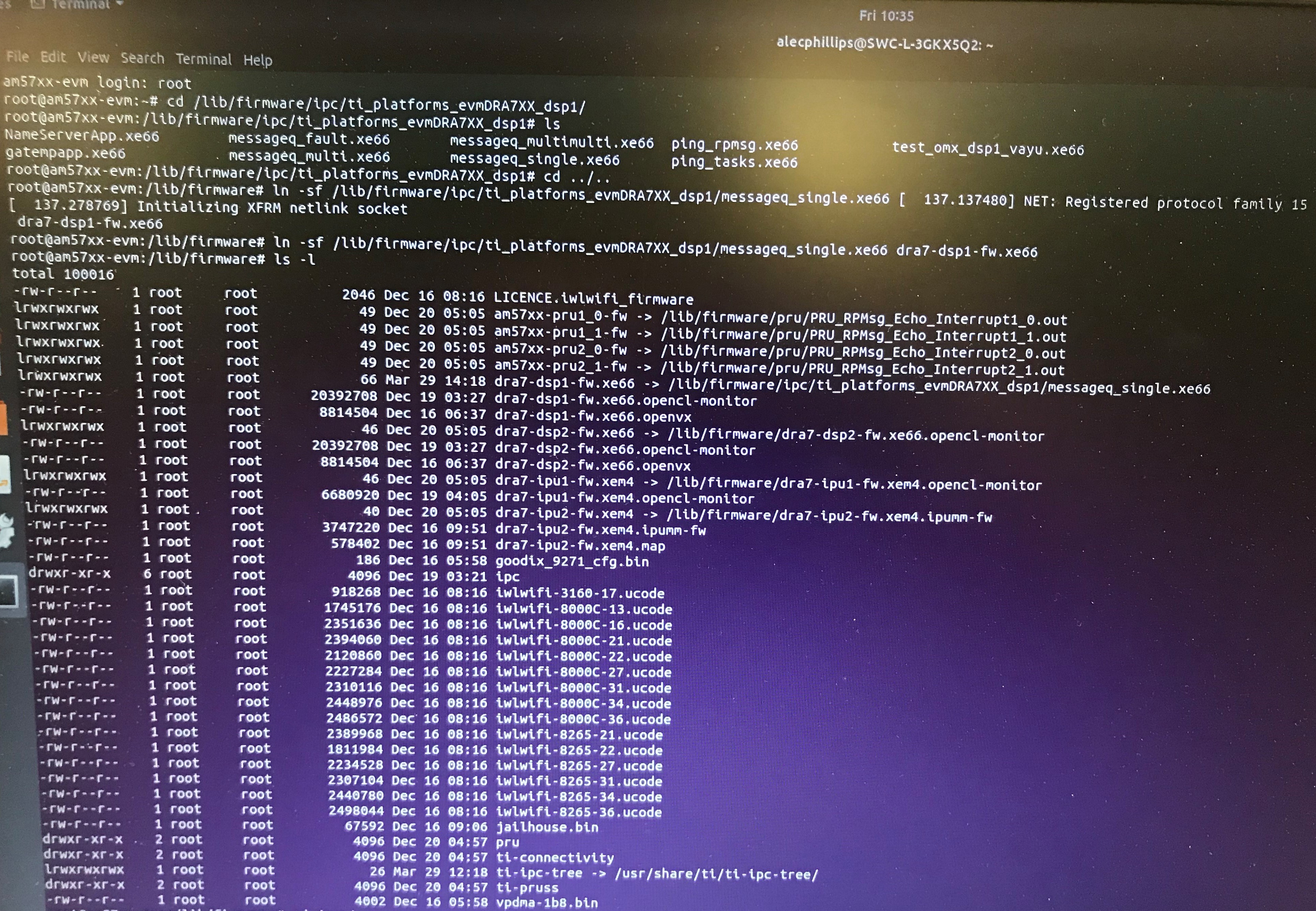

    I have decided to rebuild the SD card since I had already replaced the linked file with "dra7-dsp1-fw.xe66.opencl-monitor" and it didn't work. I'd rather start fresh at this point. I will post again if I have trouble running the MessageQBench pre-built binary.

  • Rex,
    Rex Chang said:
    You don't really need to care about the original dra7-dsp1-fw.xe66 link and the opencl-monitor binary.
    You need to overwrite the link to use the messageq_single.xe66 any way.
    When viewing the list of files in /lib/firmware/ the link to the DSP2 is to the opencl-monitor binary. How can you say I don't need to care about that?
    I set the link as you suggested and it did not repair the MessageQBench application's functionality. It still gets held up after execution. Previously, before I was changing around the binary pointer for DSP1, the MessageQ Example 02 app worked. I tried it out now, after changing the pointer to the messageq_single.xe66, and that application also doesn't work.
    I tried to "fix" the IPC by copying over the files from the Ubuntu system, but everything is read-only. I checked my physical card and it is unlocked. This is very frustrating to be going in circles with no improvement.
    A fresh SD card appears to be my only option at this point.
    Alec

    It should be a very simple task, but I am not sure where it went wrong and causes all these issues.
    The reason I said dsp2 using opencl-monitor binary won't matter because it's not the core we run MessageQBench against. Only if you want to run the bench binary to dsp2, then the dsp2 needs to use the messageq_single.xe66. By linking the binary is not enough. I assume you had either unbind/bind the dsp after changing the link, or reboot the system. My EVM is freed, and I had both links pointed to the messageq_single.xe66 earlier, so I modified the dsp2 to point to opencl-monitor. My console logs are shown below. Did you do anything differently from mine?
    root@am57xx-evm:/lib/firmware#
    root@am57xx-evm:/lib/firmware# ls -l dra7-dsp?-fw.xe66
    lrwxrwxrwx 1 root root 66 Dec 16 03:38 dra7-dsp1-fw.xe66 -> /lib/firmware/ipc/ti_platforms_evmDRA7XX_dsp1/messageq_single.xe66
    lrwxrwxrwx 1 root root 66 Dec 16 03:38 dra7-dsp2-fw.xe66 -> /lib/firmware/ipc/ti_platforms_evmDRA7XX_dsp2/messageq_single.xe66
    root@am57xx-evm:/lib/firmware# ls *.opencl-monitor
    dra7-dsp1-fw.xe66.opencl-monitor dra7-ipu1-fw.xem4.opencl-monitor
    dra7-dsp2-fw.xe66.opencl-monitor
    root@am57xx-evm:/lib/firmware# ln -sf dra7-dsp2-fw.xe66.opencl-monitor dra7-dsp2-fw.xe66
    lrwxrwxrwx 1 root root 32 Dec 16 06:21 dra7-dsp2-fw.xe66 -> dra7-dsp2-fw.xe66.opencl-monitor
    root@am57xx-evm:/lib/firmware# reboot -f now
    [EVM reboot]
    am57xx-evm login: root
    root@am57xx-evm:~# uname -a
    Linux am57xx-evm 4.14.79-gbde58ab01e #1 SMP PREEMPT Thu Dec 20 04:51:24 UTC 2018 armv7l GNU/Linux
    root@am57xx-evm:~# l[ 28.565773] NET: Registered protocol family 15
    s [ 28.621955] Initializing XFRM netlink socket
    root@am57xx-evm:~#
    root@am57xx-evm:~#
    root@am57xx-evm:~# ls -l /lib/firmware/dra7-dsp?-fw.xe66
    lrwxrwxrwx 1 root root 66 Dec 16 03:38 /lib/firmware/dra7-dsp1-fw.xe66 -> /lib/firmware/ipc/ti_platforms_evmDRA7XX_dsp1/messageq_single.xe66
    lrwxrwxrwx 1 root root 32 Dec 16 2018 /lib/firmware/dra7-dsp2-fw.xe66 -> dra7-dsp2-fw.xe66.opencl-monitor
    root@am57xx-evm:~# MessageQBench 100 8 4

    Using numLoops: 100; payloadSize: 8, procId : 4
    Entered MessageQApp_execute
    Local MessageQId: 0x80
    Remote queueId [0x40080]
    Exchanging 100 messages with remote processor DSP1...
    DSP1: Avg round trip time: 141 usecs
    Leaving MessageQApp_execute
    root@am57xx-evm:~#
  • Hi Rex,
    Thanks for going through it for me. I had forgotten to select ProcID 4 when re-running the fixed file link. Now when I execute the MessageQBench program, it works.
    Now if I want to modify the application, and rebuild it; what do I do? Once I can accomplish my original goal, I can close the thread.
    Thank you,
    Alec
  • Hi, Alec,
    I know it is a bit confusion especially that the same code runs on different platforms with different number of DSP cores. Originally, it was for KS2 family which only has DSP cores, but with Sitara family, it has IPUs. So, the default target of dsp1/CORE0 becomes CORE3 (procid 4).
    Any way, I am glad that you got the demo working. You can modify the "RTOS_SDK"/ipc/linux/src/tests/MessageQBench.c code on Ubuntu machine. Once you are done modifying, you just do a high level build (make ti-ipc-linux) in "Linux" SDK on Ubuntu machine. The DSP binary will be in "RTOS_SDK"/ipc/linux/src/tests/.lib. I put "" around to bing your attention on the SDK changes
    Don't forget to set the environment variables as described in Quick Start Guide.
    If you modify messageq_single.c, then follow the instruction in "Rebuilding the demo" under "DSP RTOS" section to build ipc_bios (make ipc_bios) in RTOS_SDK/processor_sdk_rtos_<platform>_<version> directory. Again, set the environment variables and "source ./setupenv.sh" as described in the Quick Start guide.
    I suggest that you exercise the build before making any changes to be sure you can build and run the MessageQBench from what you build. Then, start modifying the code.
    Rex
