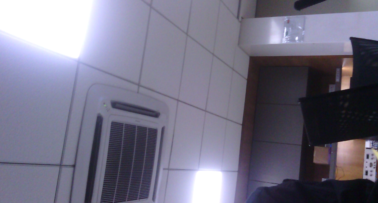

  • Here's the UYVY image to compare with,
    Thank you for sharing the pictures.
    Let me confirm that the cal driver could capture in MEDIA_BUS_FMT_RGB565_2X8_LE but it seems it can(refer cal.c file).
    On other hand I have checked ov5640.c (in PSDK 5.02, linux version 4.14.79+) and it seems it could capture in sensor->fmt.code = MEDIA_BUS_FMT_UYVY8_2X8 only.
    BR
    Margarita
