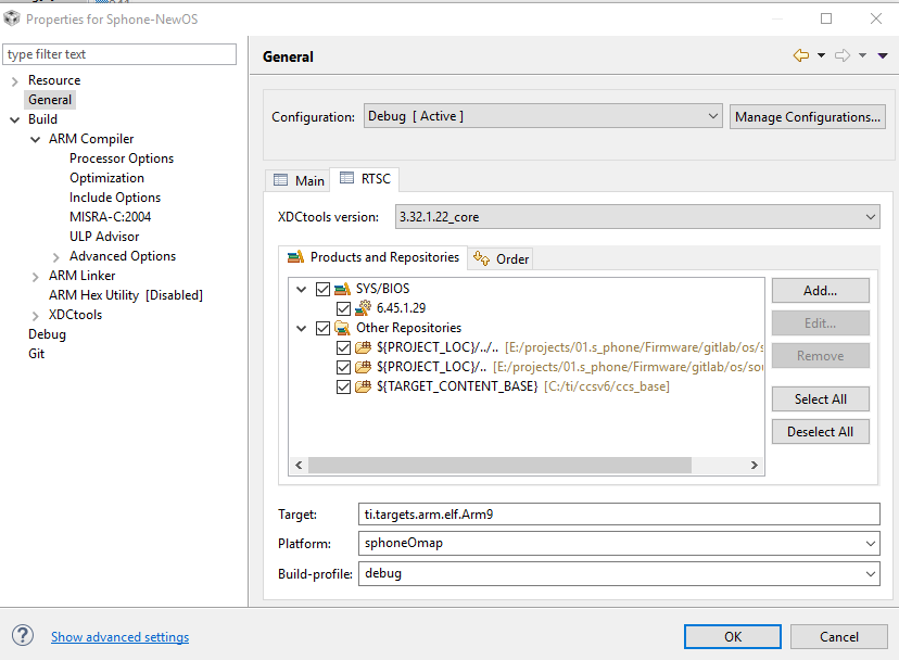

Now I'm develop feature ARM put DSP into sleep mode in OMAPL138.
I had done put DSP into sleep mode by ARM of OMAPL138. But When I wake DSP up by ARM, DSP not wakeup, and after DSP not working. I don't understand why?
I follow the steps detailed in 10.7.4 C674x Megamodule Clock ON/OFF of SPRUH77.

The running result : ARM running normal. But DSP print log "pdc interrup" and then DSP does not work.
could someone help me put DSP sleep and wake up it?
