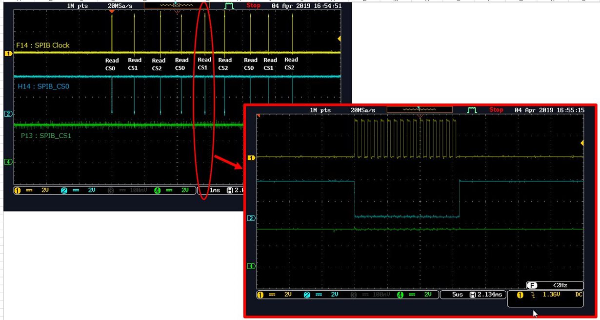

I want to connect 3 devices to SPI_Bport and switch control with ChipSelect[0/1/2].
I tried SPI Read while switching ChipSelect CS0/CS1/CS2, but CS0 is always enabled. CS1 and CS2 doesnot work.

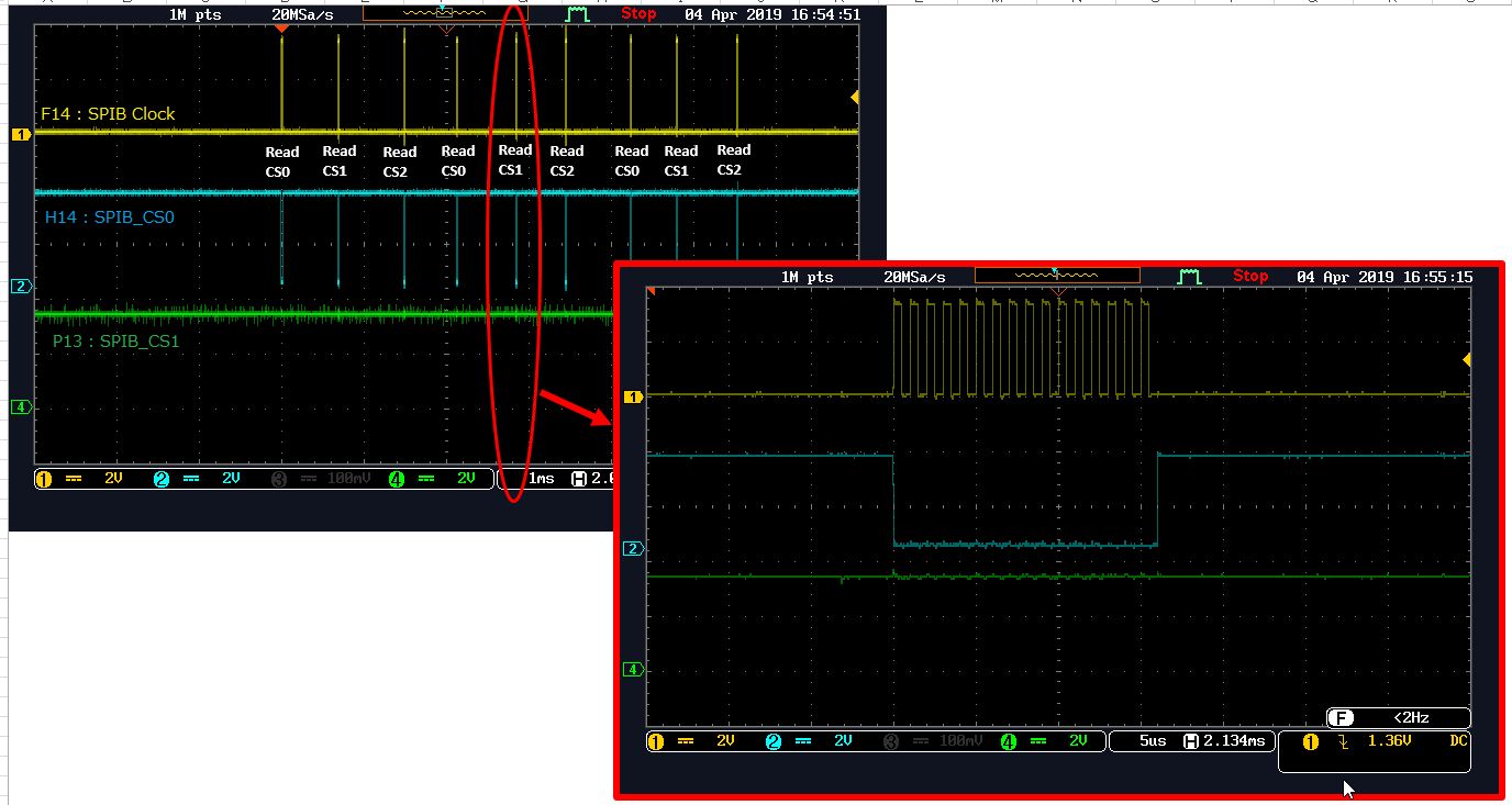

4. As a result of checking the waveform, CS0 is always enabled. Even if it accessed CS1/CS2.
Are there any problems with the procedure for test steps?
or Is there any other root cause?

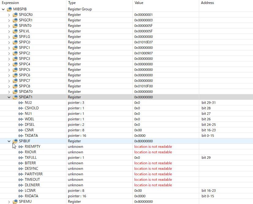

    Can you please check the below registers in the MIBSPIB when you send the slave 2 and slave 3?
    "SPIDAT1 : CSNR" and "SPIBUF : LCSNR"
    -Raghu

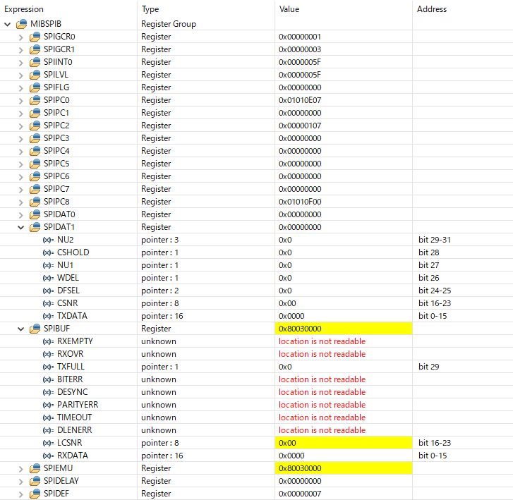

    I dumped Register.please check attached logs.
    case1 : when read SPIB slave2(CS1)
    case2 : when read SPIB slave3(cs2)
    Sorry for my delayed reply.
    The configurations in the code seem to be fine. But the register CSNR do not show the right value based on your slave select.
    Can you make sure some of the pinmux are not being overwritten in you code?
    -Raghu

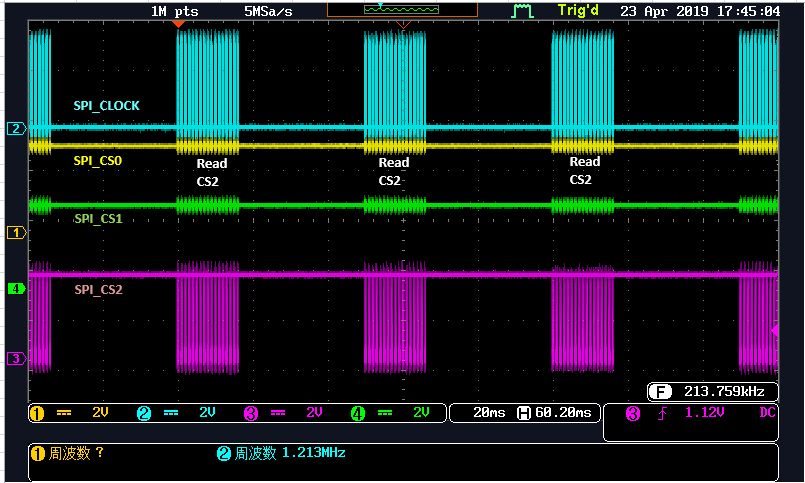

    I found that CS[2] worked fine after I changed some SPI parameters and did some tests.
    ■ Here is my test procedure:
    1. Change the ramBufLen of CS[2] to MIBSPI_RAM_MAX_ELEM(64).
       ramBufLef of CS[0] and CS[1] are set to 0.
    params.u.masterParams.numSlaves = 3;
    params.u.masterParams.slaveProf[0].chipSelect = 0U;
    params.u.masterParams.slaveProf[0].ramBufLen = 0;
    params.u.masterParams.slaveProf[0].dmaCfg.txDmaChanNum =0U;
    params.u.masterParams.slaveProf[0].dmaCfg.rxDmaChanNum =1U;
    params.u.masterParams.slaveProf[1].chipSelect = 1U;
    params.u.masterParams.slaveProf[1].ramBufLen = 0;
    params.u.masterParams.slaveProf[1].dmaCfg.txDmaChanNum =2U;
    params.u.masterParams.slaveProf[1].dmaCfg.rxDmaChanNum =3U;
    params.u.masterParams.slaveProf[2].chipSelect = 2U;
    params.u.masterParams.slaveProf[2].ramBufLen = MIBSPI_RAM_MAX_ELEM;
    params.u.masterParams.slaveProf[2].dmaCfg.txDmaChanNum =4U;
    params.u.masterParams.slaveProf[2].dmaCfg.rxDmaChanNum =5U;
    2. Write SPI on CS[2]
    int main()
    	SPI_Transaction transaction;
    	transaction.count = 2;
    	transaction.txBuf = outBuffer;
    	transaction.rxBuf = inBuffer;
    	transaction.slaveIndex = 2;
    	SPI_transfer( Spihandle, &transaction )
    ■ Here is the waveform
        CS[2] is now activated.
    ■ MIBSPIB register values
    I have a question now.
    Originally I set the following values on CS[0], CS[1] and CS[2].
    params.u.masterParams.slaveProf[0].ramBufLen = MIBSPI_RAM_MAX_ELEM/4;
    params.u.masterParams.slaveProf[1].ramBufLen = MIBSPI_RAM_MAX_ELEM/4;
    params.u.masterParams.slaveProf[2].ramBufLen = MIBSPI_RAM_MAX_ELEM/2;
    In this setting, CS[0] is always activated although I tried to use CS[1] or CS[2].
    Is this correct behavior on SPI driver?
    -chunzhou
  • Hi Chunzhou,
    We are checking on this issue.Attached is the driver modification to address some of the multiple slave support. Could you please check and let us know if this resolves your current issue?mibspi_dma.c
  • Hi Raghu,
    Thanks for the new driver and it works fine so far.
    I will check deeply later.
    -chunzhou
