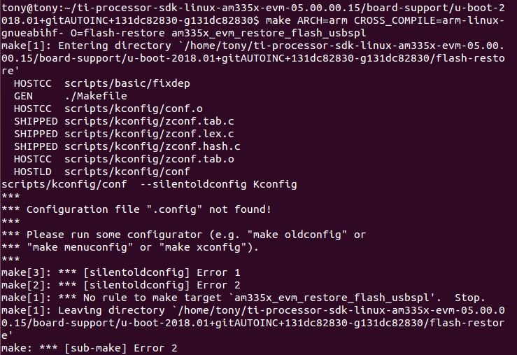

Linux/AM3358: build spl/uboot for uniflash in Processor SDK
Part Number: AM3358
Tool/software: Linux
Processor SDK: 05.00.00.15
build according to this URL guide: http://processors.wiki.ti.com/index.php/Sitara_Uniflash_Flash_Programming_with_U-Boot
make ARCH=arm CROSS_COMPILE=arm-linux-gnueabihf- O=flash-restore am335x_evm_restore_flash_usbspl
fail as below, does latest Processor SDK still need to patch to support uniflash?
Where to download patch for difference version SDK?

  • Tony,
    The latest SDKs no longer need these patches. The pre-built files provided with the SDK should boot from either USB or Ethernet. This is the primary need to support Uniflash. Once you boot from either USB or Ethernet, the system needs to get the file from the host and write them to the flash.
    I'm sorry the guide is out of date.
