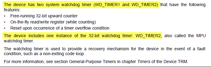

As i have understood it there are two possible sources in the AM5748 which can be used to implement watchdog functionallity in the A15 cluster.
1: MPU_WD_TIMER, which has two channels
2: WD_TIMER2
As far as I can read the TRM the MPU_WD_TIMER will use the same main clock source which is used for creating the A15 main clock (in my case derived from the OSC0 20MHz input oscillator) is this correct? Is this also true for WD_TIMER2?
In summary, my question is: Is it possible to source either MPU_WD_TIMER or WD_TIMER2 from another clock-source than whats used to clock the a15 core complex, e.g. OSC1 when OSC0 is used as main clock input? Reason for asking is that I want to implement an independent watchdog which would react e.g. if main oscillator fails.
