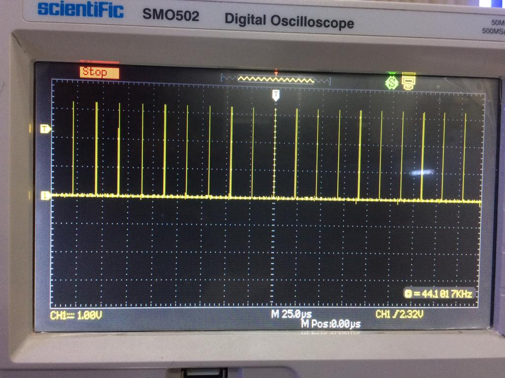

    Now i'm getting clock & signals on MCLK & DATA_OUT pins but can't hear any audio on speaker.
    While playing audio i'm getting below error
    root@am57xx-evm:~# aplay audio/HIGH.wav
    Playing WAVE 'audio/HIGH.wav' : [   33.237134] tlv320aic31xx-codec 0-0018: Can not produce exact bitclock
    Signed 16 bit Little Endian, Rate 44100 Hz, Mono

    Adding #define DEBUG in tlv320aic31xx.c file I'm getting below output
    dmesg | grep tlv
    [ 7396.675807] tlv320aic31xx-codec 0-0018: ## aic31xx_hw_params: width 16 rate 44100
    [ 7396.675820] tlv320aic31xx-codec 0-0018: Can not produce exact bitclock
    [ 7396.686734] tlv320aic31xx-codec 0-0018: pll 4.4100/1 dosr 100 n 4 m 5 aosr 100 n 4 m 5 bclk_n 15

  • Hello Pavel,
    Here i'm getting 20 Mhz on MCLK pin
    44.1 KHz on WCLK pin
    1.47 MHz on BCLK pin
    Jigar
    This doesn't seems to be correct. From what I understand, you need to have 1.4112 MHz on that pin. Seems that AIC3100 codec can not produce the correct bit clock (1.4112MHz) output from 20MHz MCLK input. You need to check this with AIC31x codec experts in Audio forum.
    You might also check what frequency your have on BCLK codec clock pin at rate 44.1KHz on TI AM572x EVM or X15 board, and compare the result with your custom board.
    If you have further questions related to AM57x McASP module, please let me know.
    Pavel
