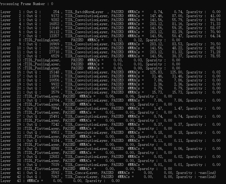

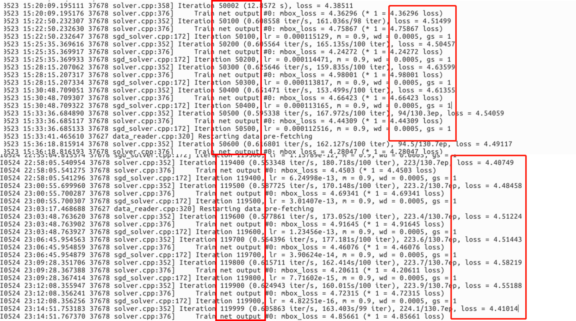

I use the ssdJacintoNetV2 which isTi provided Object detect net in caffe-jacinto do a binary task of Vehicle recognition。
1、And after training,it can work on the PC,but when I import it into bin to run on the evm, it show black screen,The transformation process is as follows.  But i import the demo trained model of voc0712 is OK.
2、Regardless of whether I use this network for binary or multi-category training tasks, the loss value remains around 4.4,show as blow. why?
    Can you please describe the steps how are you running on EVM? Also share the config file used to run these bin files on EVM?

    step1、modify the deploy.prototxt in the end filed " keep_top_k: 20   confidence_threshold: 0.15 "
    step2、I use the cammand .\tidl_model_import.out.exe tidl_import_JDetNet_desay.txt transform the caffemodel to bin
    step3、Modify  the file "TIDL_SSD_CFG.TXT" netFileName=tidl_net_jdetNet_ssd_caronly.bin paramFileName=tidl_param_jdetNet_ssd_caronly.bin
  • I am also try to train the voc dateset into 3classes, It can run on the EVM after tramform caffemodel to bin .is this ssdJacintoNetV2 net can't do one class task?

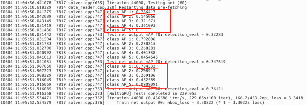

    The reason is that some of my dataset label are a little too small, As a result, the training accuracy is not high, the loss value is always around 4.5, and the sparse training process is also very bad.
    Can you share some  training  experience to me about the ssdJacintoNetV2. My recognition rate is not very good now.
