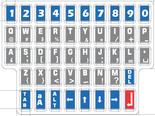

    We are using AM3352 Processor with TI Staging Linux 4.1.18 and we need help form your side about TCA8418 I2C Matrix Keypad Same Key with Multiple Function. In my product Qwerty key(A-Z, a-z) working properly but Special characters not working.

  • Hi Siva,
    Are the issues related to (a) specific button(s) or combination of buttons?  If so, which ones?  I looked at the schematic you uploaded and it seems to just have the keypad array - do all of the ROW/COL IOs connect directly to the TCA8418, or are any other components (pull-up resistors, filtering capacitors, etc.) used?
    Max
  • Hi Max,
                   Thanks for the update. As far as your question concern, we don't find any issues regarding Matrix Keypad(A-Z, a-z, 0-9, Navigator button) & hardware. My query is that I need to work on combination of buttons( ALT + Q=@, ALT + W=#). Kindly sort out my only query regarding the combination of buttons as my thread explained.
  • Siva,
    Does this issue occur with all combinations of two buttons, or only a few?  Is the first button press of the combination recorded successfully but not the second?  Do the results vary if you hold the first button down for a few seconds before holding down the next one?  Can you tell if both button presses are being logged correctly in the TCA8418 event table?
    Max
