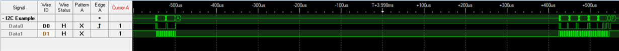

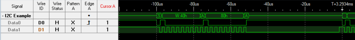

We then tried to debug it by doing the some read transactions and capturing it using a logic analyzer to see what was going wrong and following was observed,
  • Code download from  DSP  and read from  DSP  it  was seen that the delay between the write and read frame varies from 50-600 us.  No fails seen out of 1000 reads.
  • Code download from ARM and read from ARM it  was seen that the delay between the write and read frame is around 40-60 us every time. No fails seen out of 1000 reads.
  • Code download from ARM and read from  DSP it  was seen that the delay between the write and read frame  varies from 5-600 us, at times whenever read took <20us we saw that the read failed with the clock stretching untill timeout.
we noticed a peculiar observation from the captures, was that there is no clock stretching  just after the address read block from ARM but it does stretch every time from DSP.
Conclusion
  • If we were to perform the read from the same core where the code download happened the read never failed.
  • When the i2c peripheral is shared i.e., we were to perform the read from the  DSP core and the code download form  ARM read becomes inconsistent and fails.
