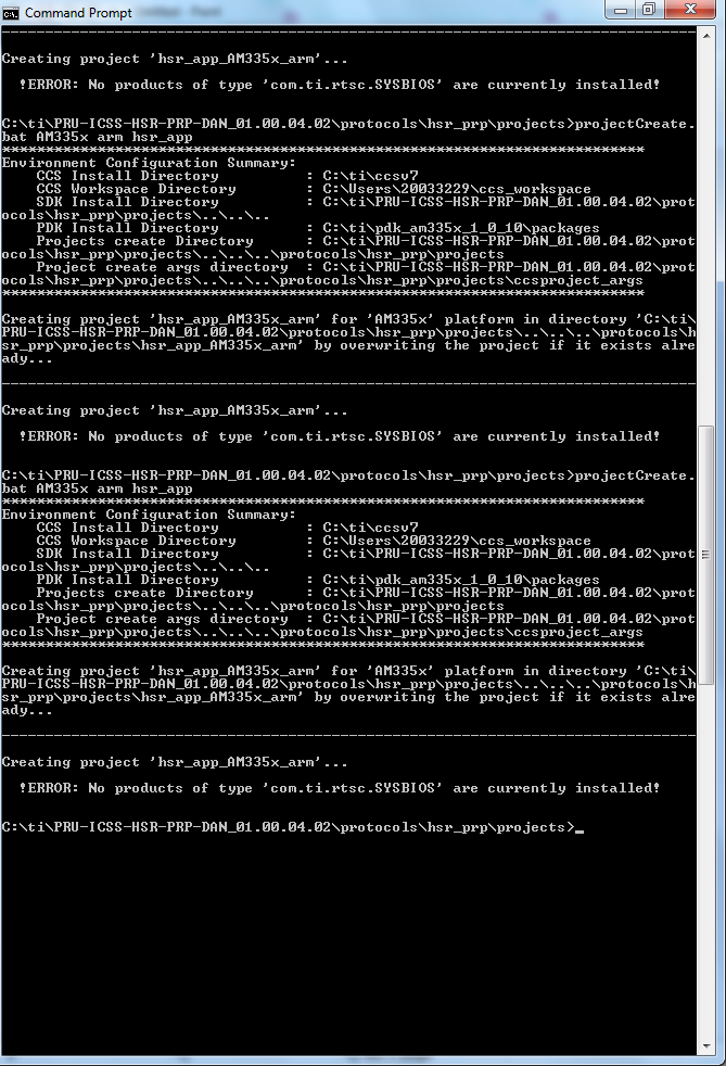

I am trying to generate project for HSR application.
http://processors.wiki.ti.com/index.php/PRU_ICSS_HSR_PRP
i am facing below problem.
No products of type "com.ti.rtsc.SYSBIOS" are currently installed!.
PFA of screen shots.
Kindly help.
VR
  • Hi Vrund,
    It's very likely that you haven't opened the CCS to detect the tools/drivers after the PRSDK is installed.
    Garrett

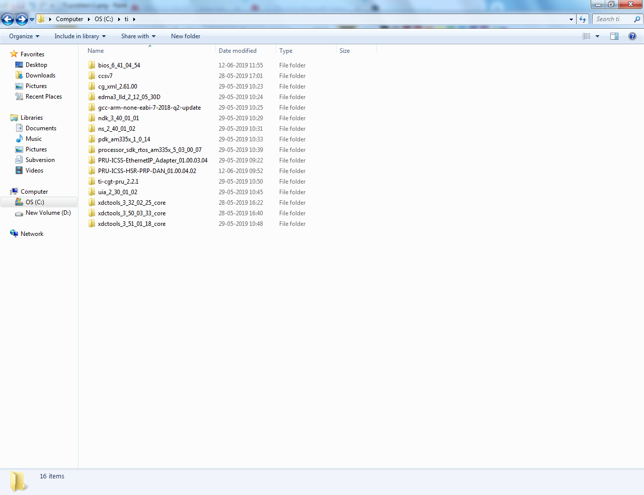

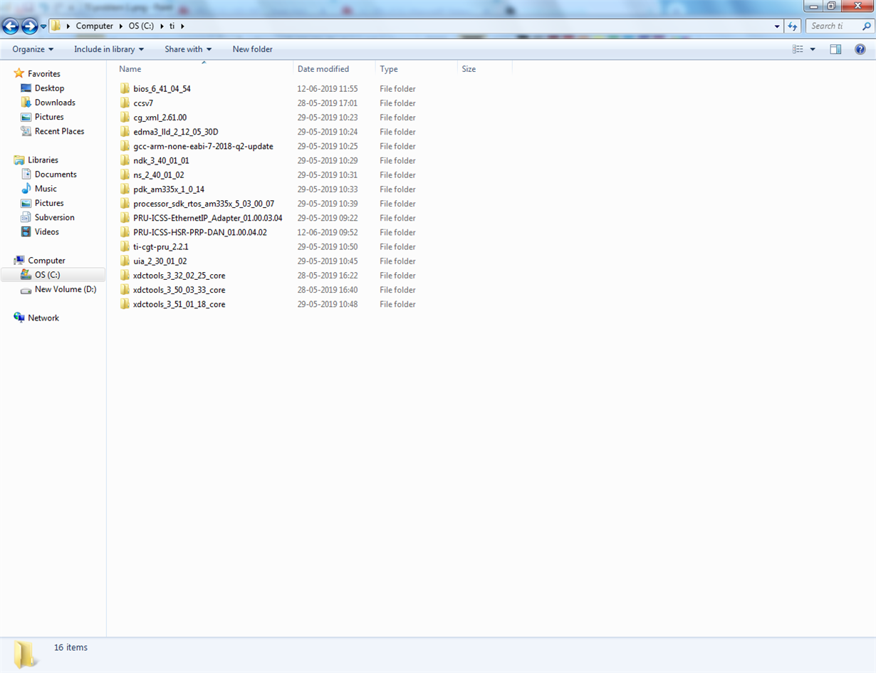

    projectCreate.bat requries ndk version
    NDK_VERSION=2.26.00.08
    but i have used 3.40.01.01
    and processor_sdk_rtos_am335x_5_03_00_07
    is it ok?
    i am facing problem while compiling.
    subdir_rules.mk:12: recipe for target 'build-1111334305-inproc' failed
    gmake: *** No rule to make target 'C:/ti/pdk_am335x_1_0_10/packages/ti/drv/gpio/soc/am335x/GPIO_soc.c', needed by 'soc_am335x/GPIO_soc.o'.
    gmake: *** No rule to make target 'C:/ti/pdk_am335x_1_0_10/packages/ti/drv/i2c/soc/am335x/I2C_soc.c', needed by 'soc_am335x/I2C_soc.o'.
    gmake: *** No rule to make target 'C:/ti/pdk_am335x_1_0_10/packages/ti/drv/spi/soc/am335x/SPI_soc.c', needed by 'soc_am335x/SPI_soc.o'.
    gmake: *** No rule to make target 'C:/ti/pdk_am335x_1_0_10/packages/ti/drv/uart/soc/am335x/UART_soc.c', needed by 'soc_am335x/UART_soc.o'.
    gmake: *** No rule to make target 'C:/ti/pdk_am335x_1_0_10/packages/ti/drv/icss_emac/soc/am335x/icss_emacSoc.c', needed by 'soc_am335x/icss_emacSoc.o'.
    gmake: *** No rule to make target 'C:/ti/pdk_am335x_1_0_10/packages/ti/drv/pruss/soc/am335x/pruicss_soc.c', needed by 'soc_am335x/pruicss_soc.o'.
    VR
  • VR,
    You must use the Processor SDK v4.3 as specified in the HSR/PRP user guide at this point.
    software-dl.ti.com/.../index_FDS.html
    And the components of PRSDK v4.3 is listed here -
    Garrett
  • hi,
    getting this error.
    gmake: Target 'all' not remade because of errors.
    Regards,VR
  • VR,
    Which error? can you please post the error log?
    Have you applied the patch under PRU-ICSS-HSR-PRP-DAN_01.00.04.02\protocols\pdk_patches\04.03.00 to PDK and rebuild the libraries icss_emac and nimu_icss or replace them with the zipped files (icss_emac.zip and nimu_icss.zip) in the same directory?
    Garrett
