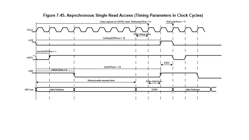

I am interfacing dpram with AM335x.
During this i observed two point i need more information on those points.
1>  from below figure you can see for read acess(Its from am335x datasheet).
First valid address comes on bus and ALE goes high.
Then cs goes low and ale again high.
Now below image is from trm of am335x and here
first ale goes high with valid data on bus.
Then cs goes low but in this case ale remains high .
can you tell me which one is ok case.
