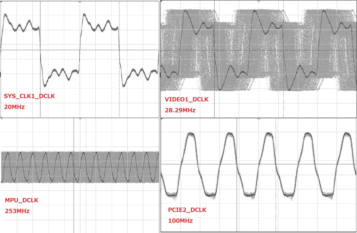

My customers could to confirm SYS_CLK1 from clkout2.
When they confirmed SYSCLK from clkout2, they could confirm a beautiful waveform.
However, if you check MPU_DCLK or VIDEO1_DCLK, the waveform is distorted.
The power supply has no noise and can not find causes.
Are there any possible causes?

    #2  The clock waveform captures do not have enough information to determine "goodness".  Vertical deflection, ground reference and timebase are minimum requirements.  Note that the clkout# outputs are LVCMOS drivers so that are bandwidth limited at about 200MHz.  The amplitude will be restricted as you approach the limit.  Also note that these clkout2 and clkout3 outputs have limited use as shown in the notes in Section 4.4.26 of the Data Manual.  They are not intended as high performance clocks used to drive other circuitry.

    I do not see anything in these scope shots that is problematic.
    1. SYS_CLK1_DCLK appears to be an unterminated  20MHz output.  Transition edges are clean and the overshoot and undershoot do not violate VOH(min) or VOL(max)
    2. MPU_DCLK is a 250MHz clock.  Since it is beyond the frequency range of the LVCMOS buffer, the amplitude is reduced and the signal never reaches the expected LVCMOS voltage limits.  The trigger delay shows that this clock has period jitter but that is not unexpected.
    3. VIDEO1_DCLK is about 28MHz with signal integrity like #1.  The trigger delay shows that this clock has period jitter but that is not unexpected.
    4. PCIE2_DCLK is a 100MHz clock.  Since it has lower frequency than #2, you can see that it reaches the voltage rails as expected.  You also see that there is almost no phase jitter as a PCIe reference clock must be a low-jitter clock.
    Please let me know if you have further questions.
    Question 1:
    What do you mean " that is not unexpected" ?
    We think that clock jitter is bad. We have questions related to the above.

    Digital circuits are not affected by clock period jitter as long as it is bounded and never violates minimum set-up and hold requirements within the logic.  PLLs that only use integer multipliers and dividers will yield the lowest jitter but that will place unacceptable limits on system performance.  As long as you follow the guidelines provided, the clock period jitter will not cause a problem within the device.  If you want to use the clock external to the device, signal conditioning may be needed.  As stated in the Data Manual, these clkout# outputs can be used externally for devices with noncritical timing requirements, only.
