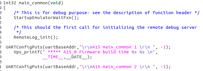

    I noticed that the code of A15 can run,But the function“ Vps_printf” cannot print out.I added the UARTConfigPuts print, which can output normally.
    The printed result is:
    Jumping to MPU CPU0 App
    A15 main_common 1
    A15 main_common 2
    I think function “ Vps_printf”  does not take effect.,How to solve this problem?

  • Hi Abel,
    In Vision SDK all prints are directed to a remote log buffer and IPU1_0 takes care of printing the logs to UART console.
    User is not supposed to directly access UART via UART driver APIs.
    In case when you use Vps_printf the print will appear somewhere later in the log depending upon the timestamp as multiple CPUs might have written to remote buffer before A15.
    Can you check the complete log to see if you get prints from A15.
    If no please share the log as an attachment.
    Rishabh

    I can't get anyprints from A15 and other cores.My log is added to the payment
    Abel

  • Hi Abel,
    This is not the main menu of Vision SDK, these prints are coming from SBL.
    It seems that there is a hang during IPC attach.
    What are the changes that you have made?
    Can you try with prebuilt SDK binary to see the expected output.
    Rishabh
