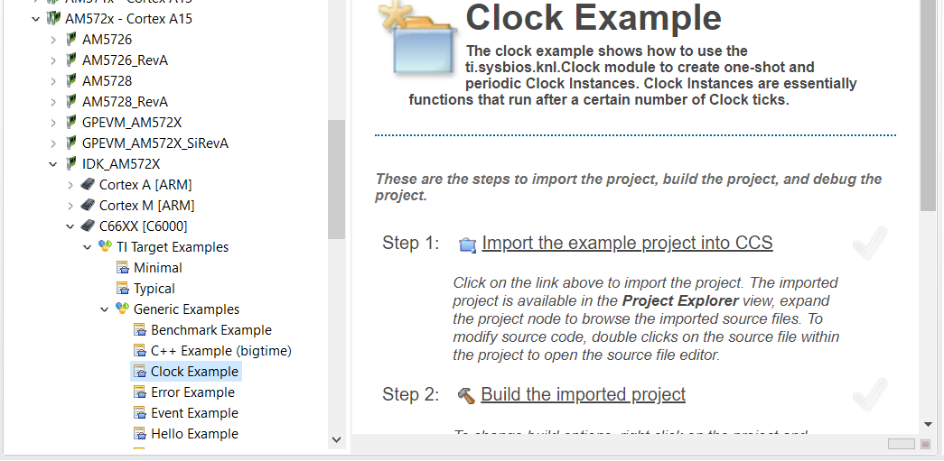

  I am trying to setup a clock handle that will post a software interrupt every 10ms.
  BIOS_getCpuFreq() gives me the DSP frequency = 600MHz.
  I setup the clock with the given parameters :
    Clock_Params_init(&my_clk_params);
    my_clk_params.startFlag = TRUE;
    my_clk_params.period = 600000; //num_ticks_to_wait = 600000 600M ticks per second, hence 600000 ticks for 10ms delay?
    my_clk_params.arg = NULL;
    my_clk_handle = Clock_create(my_clock_handler, 100, &my_clk_params, NULL); // timeout value 100 not used as startFlag = TRUE ?
  I notice that the clock_handler fires off approximately every 7 minutes, instead of the expected 10ms.
