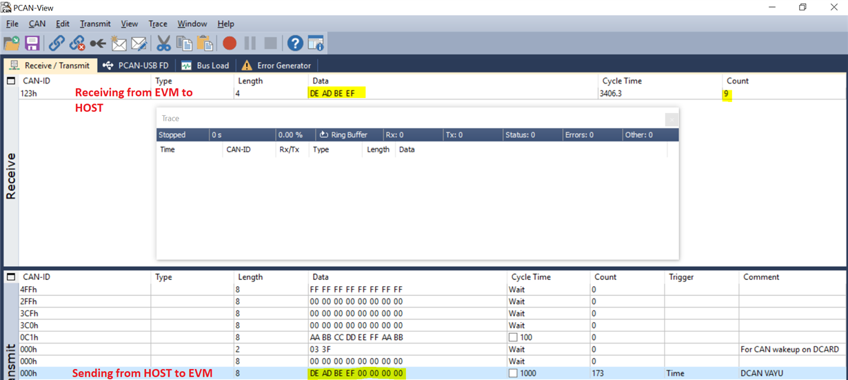

    I tried to replicate what you did on your board, here on the EVM.
    On the EVM I am able to send and receive CAN messages. Following is the log -
    root@dra7xx-evm:~# ip link set can0 type can bitrate 500000
    root@dra7xx-evm:~# ip link set can0 up
    [ 54.055864] c_can_platform 4ae3c000.can can0: setting BTR=0504 BRPE=0000
    root@dra7xx-evm:~# cansend can0 123#DEADBEEF
    [ 74.296166] can: controller area network core (rev 20170425 abi 9)
    [ 74.302906] NET: Registered protocol family 29
    [ 74.313217] can: raw protocol (rev 20170425)
    root@dra7xx-evm:~#
    root@dra7xx-evm:~#
    root@dra7xx-evm:~# candump can0
    can0 000 [8] DE AD BE EF 00 00 00 00
    The candump can0 shows the packets which I am sending from the HOST PC using the PCAN tool. And on the PCAN tool, I am also able to receive the messages sent using cansend can0 123#DEADBEEF.

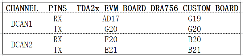

  • Hi, Karan, would you like to tell us the detailed steps  you tried on the evm-board?
    The pinmux on the evm is: 0x3d0 ( tx) and 0x418(rx).
    But our pinmux is 0x3d0(tx) and 0x3d4(rx)
    If you tried our pinmux-change on the evm borad, what changes did you do to the hardware and software?
    I have tried on the EVM with the default PINMUX.
    The steps I followed are -
    1. Install Processor SDK 5.01
    2. Create the SD card with the prebuilt images from the Processor SDK
    3. Boot the board and run the following -
    4. root@dra7xx-evm:~# ip link set can0 type can bitrate 500000
      After this you receive the message DEADBEEF on the PCAN tool
      Send the CAN message from the PCAN tool and you can see the message on the EVM by doing a candump can0
    Karan
  • Hi, Karan,
    Thanks for your work, we tried to test DCAN module on EVM, too, and it works very well. The problem is that schematic of custom board and evaluation board are different about DCAN module, the following table is detailed configuration about DCAN:
    1.Following code is that we made for DCAN1:
    /* dcan1*/
    dcan1_pins_default: dcan1_pins_default {
           pinctrl-single,pins = <
                  0x3d0     (PIN_OUTPUT_PULLUP | MUX_MODE0) /* dcan1_tx.dcan1_tx */
                  0x3d4     (PULL_UP | MUX_MODE0)  /* dcan1_rx.dcan1.rx */
    dcan1_pins_sleep: dcan1_pins_sleep {
                  0x3d0     (MUX_MODE15 | PULL_UP) /* dcan1_tx.dcan1_tx */
                  0x3d4     (MUX_MODE15 | PULL_UP)  /* dcan1_rx.dcan1.rx */
    &dcan1 {
           status = "okay";
           pinctrl-names = "default", "sleep", "active";
           pinctrl-0 = <&dcan1_pins_sleep>;
           pinctrl-1 = <&dcan1_pins_sleep>;
           pinctrl-2 = <&dcan1_pins_default>;
    Please double-check for us if it is correct.
    2. Next, we changed the connection of DCAN1 on EVM board according to schematic of custom board and then reconfigurated the device tree follow the code above. Result is sending and receiving CAN messages failed through EVM board.
    3. We are confused about the experiment, is there anything wrong with our configuration? Please let us know If you have the sample code about connections of DCAN1 and DCAN2 like our custom board.
    Thanks.
