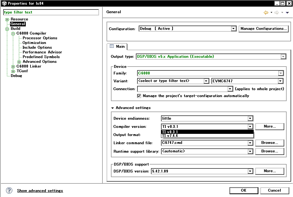

Set this compiler selection in Project_Propaties_General.

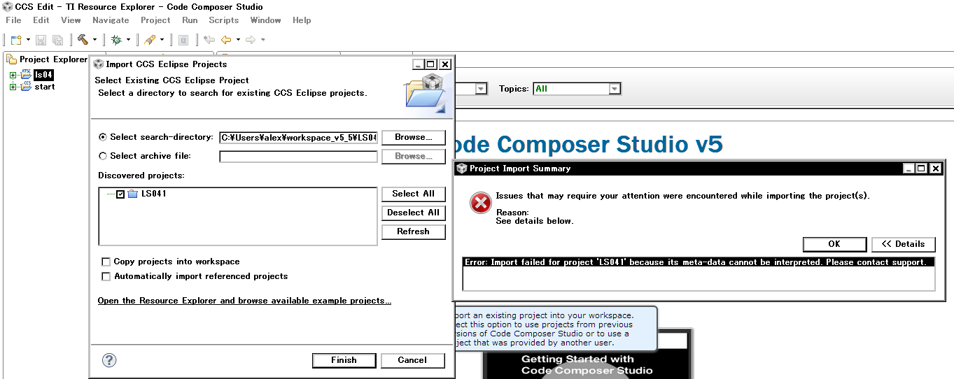

A meta-data_error occurs when importing a source file set. (This is the same as the other day)
Create a new project empty, and drag and drop source files to create a build project. However, many occurrences of "identifier" Uns "is undefined".

log, compiler selection, and Hierarchical top file

Best, regards
Suzuki
2019_0731_19: 00 @ japan
  • Please select CGT 7.4.x and make sure that the binary is not build for ELF format. You build shows use of newer compiler and --abi=eabi which indicates the build is happening for ELF binaries. I am not sure why you are creating a new project . Isn`t there an existing project CCSv3.3 project that you can import. The other issue is that I am not sure if you have std.h being included in the application.
    bios_5_xx_xx_xx\xdctools\packages\xdc\std.h
    Also, can you confirm C6747.cmd file is a file from your source and not from CCS. IF this is coming from CCS install, I would remove that as it may conflict with DSPBIOS platform configuration. Open the file in CCS Editor and check to see if there is any define expected for Uns to be defined that you may be missing in the project
    Rahul
    PS: DSPBIOS is not recommnded for new development so make sure you are trying to leverage project that you may have previously created and known to be working else we can`t support this new development effort around DSPBIOS.
  • Thanks for replying to me Mr. Rahul
    Currently, I can avoid yesterday's error and I have another error.
    I will explain the process in order.
    You say CGT should be 7.4x. From the previous error message, I daredly installed 8.3.1, but I found that there was another cause, so I'll go back to 7.4.4. The output format was legacy COFF.
    The way to create a new project was unavoidably done.
    When I import a project called LS041, I get an error like attached image ccs55_import_error.png, so I changed it to the new project method.
    I will also send a file list of files called LS041.
    std.h and C6747.cmd are included in that LS041.
    And C6747.cmd was also in pspdrivers . That is the driver I installed additionally. And based on what you suggested, I deleted the driver I was adding.
    Two additional drivers are
    C6747_BIOSPSP_01_30_01
    EDMA3_LLD_BIOS5_01_11_00_03
    Both are bios related.
    I uninstalled both.
    So there is no error message coming out of the window.
    What came up instead is the error of attached ccs55_CGT744_error_2019_0801.log. Please provide a solution for this.
