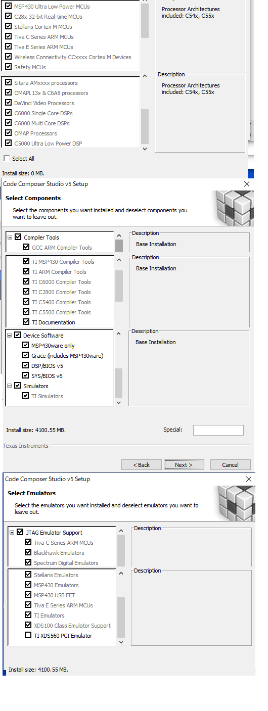

    I am launching ccsv5 with bios support.
    As I only have win10 machines, I am installing in win7 compatible mode. Please wait as it takes time.
    For now, paste the project properties in v9.

  • Hi Mr. Rahul
    I am troubled with this error now.   See details below.
    Error: Import failed for project 'LS041' because its meta-data cannot be interpreted. Please contact support.
    Here is the process.
    Dell Vostro Core_i7 / 3.4GHz / 8GB / 900GB_HDD (400GB free)
    I have uninstalled all Texas Instruments drivers & apps from win10.
    after that,
    I installed CCS5.5.0.00077_win32 in win7 compatible mode.
    Install C6747_BIOSPSP_01_30_01 in vista compatible mode.
    Install EDMA3_LLD_BIOS5_01_11_00_03 in vista compatible mode.
    When importing a source file set, I was asked to set the compiler to 8
    Install ti_cgt_c6000_8.3.1_windows_installer.exe    and set the selection in General.
    When importing a source file set, this time meta-data_error occurs.
    readMe_eng.txt
    Deployment when installing CCS4 by default
    �E Under My Documents \ workspace
    ???LS041 (Correlation operation program)
    ???boot2nd (Startup program)
    ???FROM (Flash ROM rewrite program)
    ???Copy folders
    �E Install BIOS
    ???DSPBIOS5_41_03_17                         ( Built in ccs_5.5  because ccs_9 does not support bios )
    ???C6747_BIOSPSP_01_30_01
    ???EDMA3_LLD_BIOS5_01_11_00_03
    ???Run and install the setup in each folder
    �E Copying DSP initialization setting file at ICE startup
    ???Copy evmc6747_dsp.gel to the C: \ Program Files \ Texas Instruments \ ccsv4 \ emulation \ boards \ evmc6747 \ gel folder
    ???Note: Since the evmc6747_dsp.gel file already exists in the copy destination folder, backup it if necessary.
    C: \ ti \ ccsv5 \ ccsv5 \ ccs_base \ emulation \ boards \ evmc 6747 \ gel       was replaced 2019/07/29
    The attached four files are as follows.
    *ReadMe_eng.txt  :  Translation of Readme.txt by developer 9 years ago. (Added some changes.)
    *ccs55_comp.png  :  Compiler switching setting
    *ccs_v55_incl.png  :  Installed components
    *ccs_v55_meta-data_error.png  :  Error message
    17: 30 @ japan
