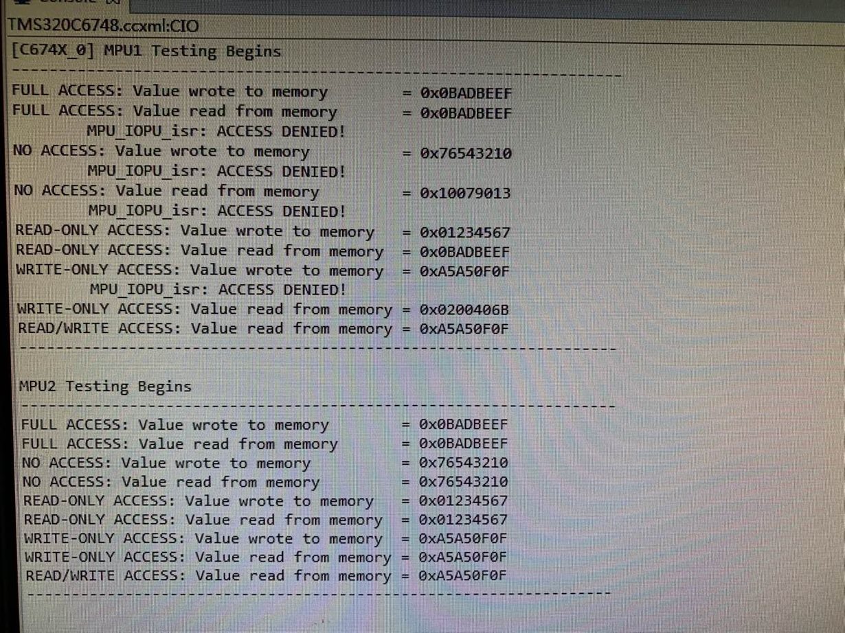

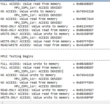

The customer used mpu_test demo attached in this link:https://e2e.ti.com/support/processors/f/791/t/158135  to test mpu in his custom board. The result indicates that DDR memory protection failed and on-chip ram is successful.
Below is his log file.
I have also test in TMS320C6738LCDK and it worked.
I am wondering if it is related to hardware design? How to locate the problem?
