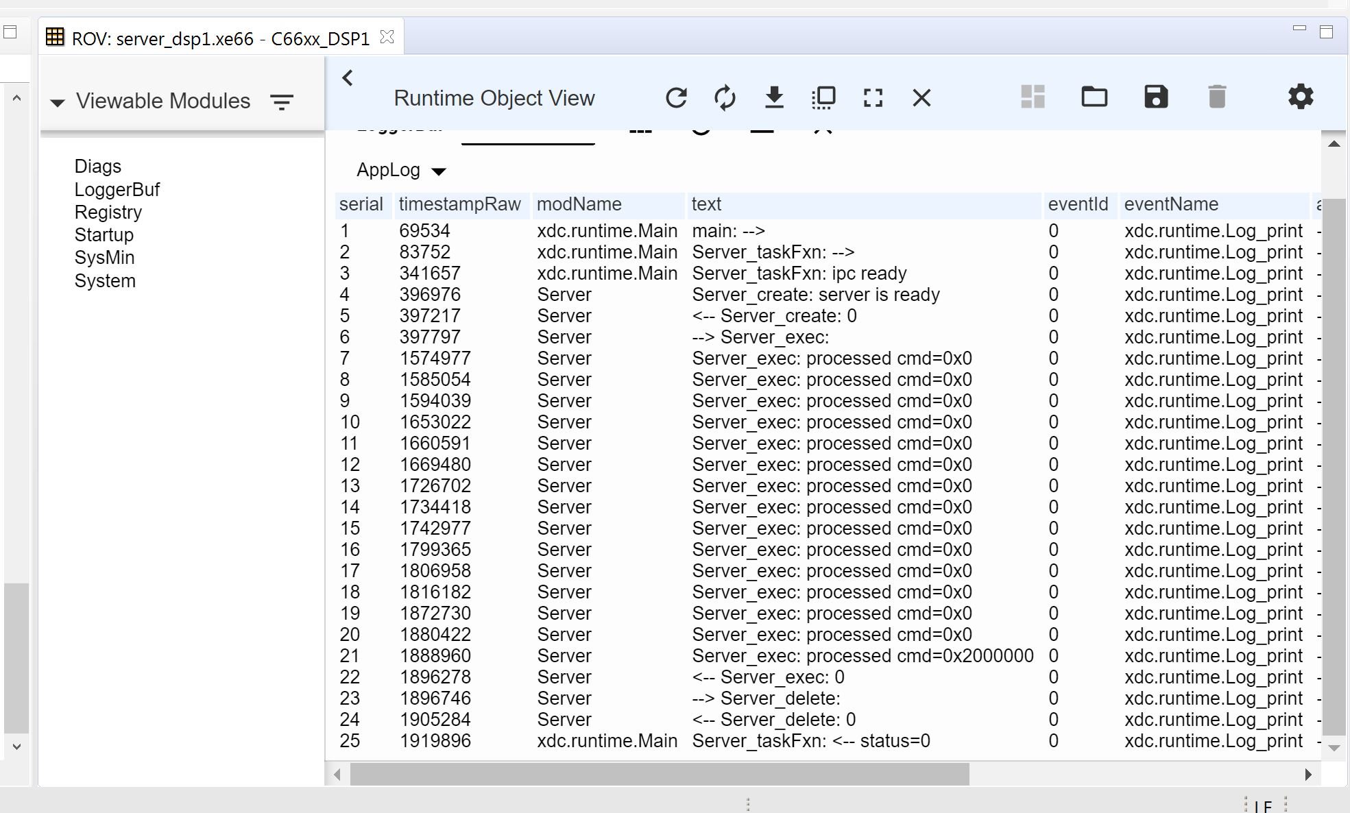

  • Hi Sahin,
    Thank you for your response. In fact, I need to use IPC in one of my projects, I started to read ti documents and then I run ti example "ex02_messageQ" which seems to work successfully (below is a screenshot of it) and I have read its source code too (although I didn't understand some parts).
    but, running ti's prebuilt examples wouldn't help me so much in my project, so I decided to start a new project and focus on implementing IPC,  connecting cores and messageQ, so that I can fully understand IPC and then use it in my main project. But still I'm stuck in Ipc_attach which returns -11, I tried to play with some configurations in .cfg files, but my problem still exists. (I attached my last version of code)
    1348.IPCTestProject.zip
