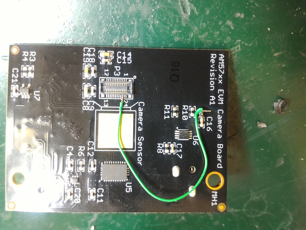

I bought a new mt9t11x camera module http://www.ti.com/tool/TMDSCM572X
I inserted it on AM5728 EVM with the SDK-06.00.00.07. My previous Camera Board gave me "
Product ID error ffffff87". I got same error with out of box Camera Module. I use am57xx-evm-reva3-cam-mt9t111.dtb file for device tree.
