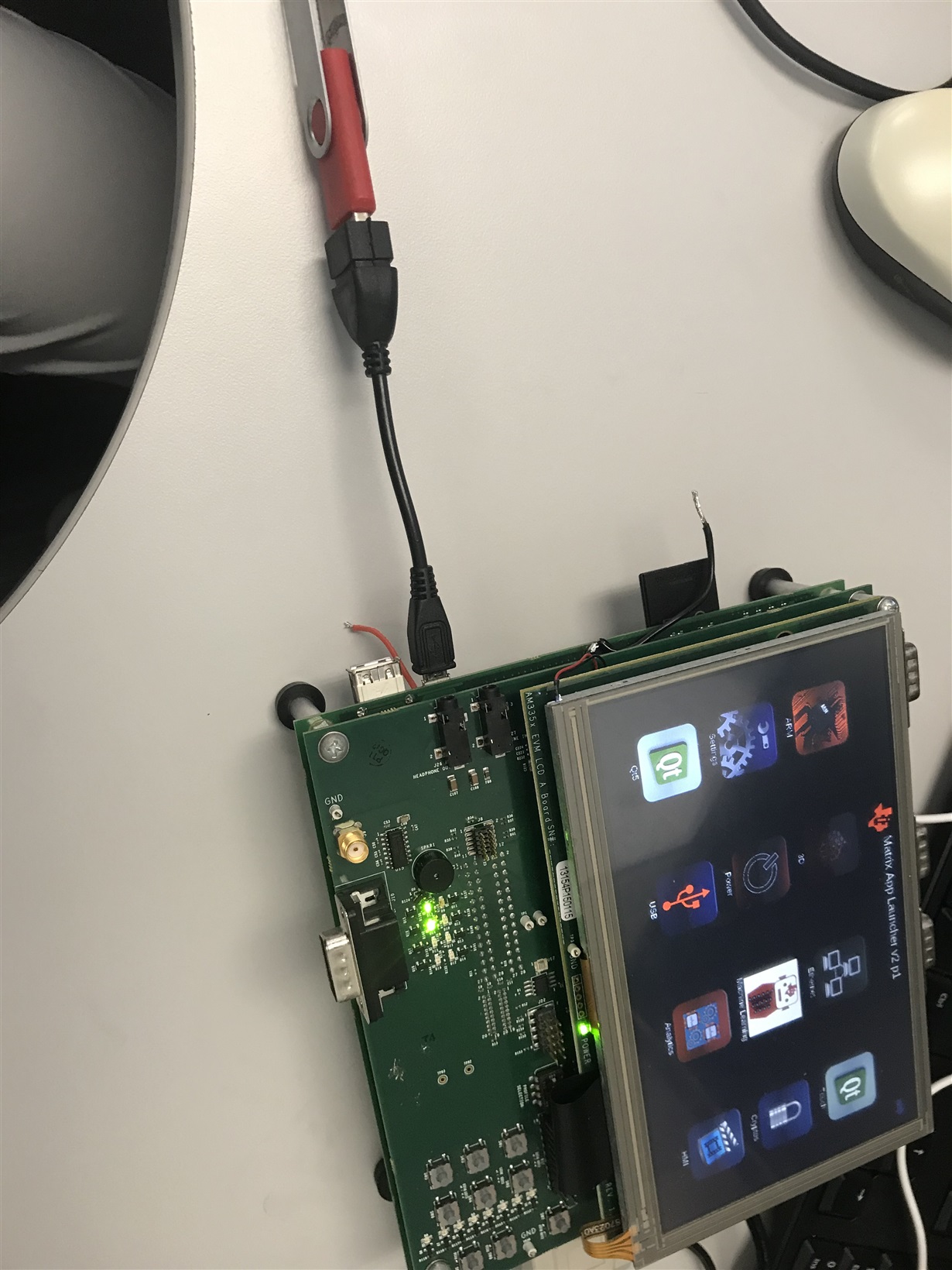

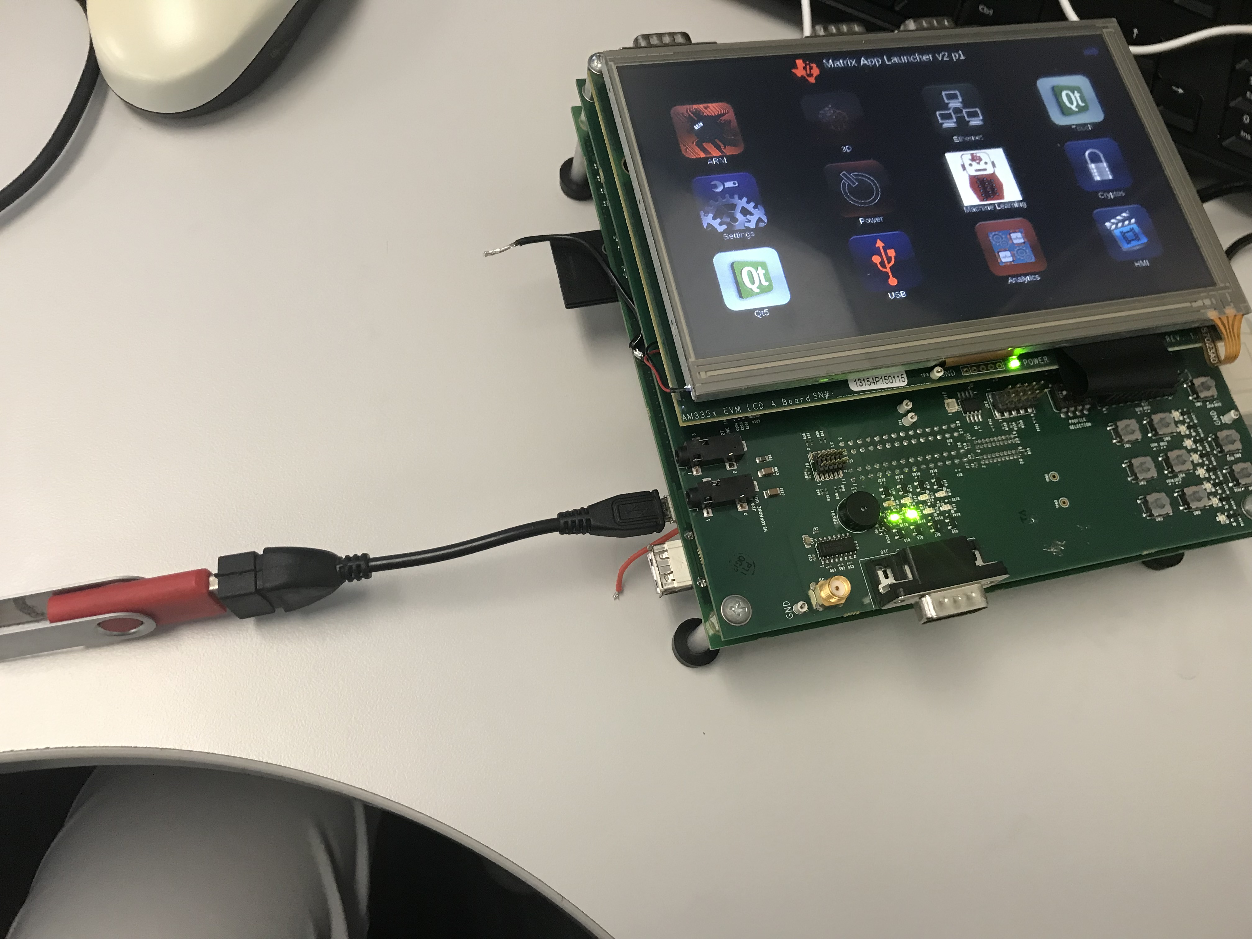

AM3352: USB0 issue on GP EVM
Part Number: AM3352
Test on GPEVM: I attach U-disk as below picture, or connect cable to PC directly, did not get enumeration log in console, PC side also did not detect the target.
Processor SDK 6.0.0.07.  create sd card with pre-build image. I removed the 120K resistor R381 and short USB0_ID to GND already.
On USB1, can detect attached U-disk.
  • Tony,
    If USB0_ID is directly grounded, the USB0 port will only work in host mode, but on longer work in device mode. So please don't connect the port to a PC usb host, or the PC could be damaged.
    To figure out why the thumb drive is not enumerated, please run the following script on the evm and provide its output.

    #1. Because the GPEVM mount 120Kohm resistor on USB0_ID pin, there is no response when I insert U-disk, so I removed the resistor and short ID pin to GND to set it to host only mode for test.
    #2. log of your script as attached.
    #3. I test with default prebuild images.Share_data.zip
